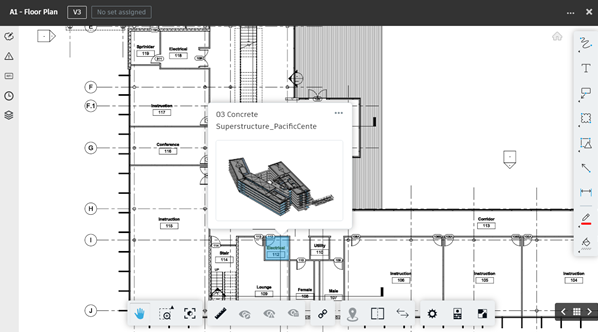

Hyperlinks are created automatically when you upload RVT, DWG, DWF 2D sheets, and raster or vector PDFs with callouts to the Plans folder.
  1. Upload and open your design or PDF file.
  2. Click the blue highlighted area of the callout.
    A preview of the sheet containing callout detail is displayed.
  3. Click View.
  4. To go back to the previous sheet, click Return.
