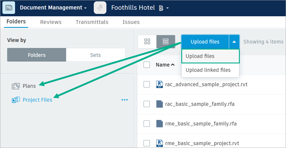

Plans and Project Files Folders
Two parent folders are created for every project:
  • Plans: Use the Plans folder to manage, download, review, and publish the latest set of construction-related documents in both 2D and 3D formats. The Plans folder houses the digital equivalent of the printed set of contract drawings for the project.
  • Project Files: Use the Project Files folder for any project-related document, including design data and all other document types including photos, reports, schedules, budgets, and requirements documents.
The table below describes the features and uses of the Plans and Project Files folders and subfolders.
Feature and Usage Plans folder Project Files folder
