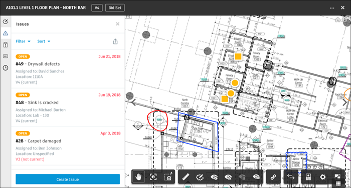

View Document-based or Model-based Issues
View the list of issues associated with a document or a model.
Note: Project members can't view issues linked to a document they have access to unless; they have VIEW or FULL CONTROL issue permissions, the issue is assigned to them, or they, or someone in their company, is the issue owner or creator.
  1. Open a 2D document or 3D model and select Issues . Optionally, on the home page, in the toolbar, select Issues .
  2. The list of all issues available in a document or a model is displayed.
  3. To apply a filter to display a subset of issues, from the Filter drop-down list select one or more filter criteria, and then click Apply.
    Tip: You can filter issues by type, status, location, assignee, issue creator, root cause, due date, and creation date.
  4. To change the order of the issues in the list, from the Sort drop-down select the desired sorting criteria. The sort order can be one of the following:
    • Title (A-Z or Z-A)
    • Status (Draft to Closed or Closed to Draft)
    • ID (Ascending or Descending)
    • Due Date (Old to New or New to Old)
  5. Click an issue to view its details, attachments, and activity associated with the issue.
