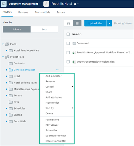

Add Folders
- In the folder tree, right-click a folder and click Add Subfolder. A new folder appears below the parent folder.
- Enter a name and press Enter.

Sort Folders
- In the folder tree, right-click a folder and click Sort by.
- Select an option from Name A-Z, Name Z-A, or date.
Rename Folders
- In the folder tree, right-click a folder and click Rename.
- Type a new name and press Enter.
