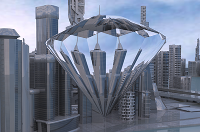

To create a glass diamond like the one above:
  1. In Action, first make sure you have a background image.
    Refraction affects whatever is behind the refracting object, so you need something in the back to see the effect.
  2. In Action, right-click the Schematic and select Import...
  3. From the import window, select PBS_Diamond and click Load.
  4. In the Action schematic, double-click the Geom node named PBS_Diamond to display its menu.
  5. In the PBS_Diamond menu, display the Geometry menu, and set Sort Box to Sort Transp.
    This ensures the polygons are properly sorted in 3D space, taking transparency into account when z-sorting its polygons.
  6. Back in the Action schematic, select the Material node named Cube and attached to PBS_Diamond.
  7. In the Cube menu, display the Blending menu and set Transparency to 100%.
  8. In the Refraction section, set IOR to that of the diamond, 2.418.
    You now have a glass cube that refracts its background. Rotate the cube to see its effect on the background.
