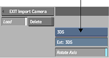

To import a 3ds Max camera:
  1. In the Camera menu, click Import.
    The Import Camera file browser appears.
  2. From the Import Type drop-down, select either the .3DS or .ase format.
  3. If needed, enable Rotate Axis to rotate the imported camera by 90° on the X-axis so that it is compatible with Action's coordinate system.
  4. Navigate to the location where a 3ds Max camera setup was exported, and select the file.
    You return to Action and the imported camera is applied to your scene.

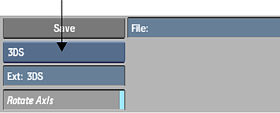

To export a camera to 3ds Max format:
  1. Select the camera you want to export.
  2. In the Camera menu, click Export.
    The Export Camera file browser appears.
  3. From the Export Type drop-down, select 3DS.
  4. If needed, enable Rotate Axis to rotate the exported camera by -90° on the X-axis so that it is compatible with the coordinate system of the 3D application.
  5. Navigate to the location where you want to export the camera animation.
  6. Enter a name for your exported camera in the file field.
  7. Click Save.
Tip: When exporting from Flame, save the .3DS file in a directory that is readable by a 3ds Max system.
