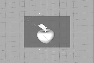

| Front view | ![]() |

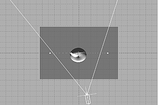

| Side view | ![]() |

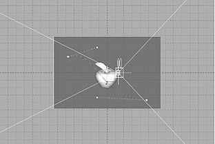

| Camera view | ![]() |

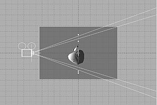

| Top view | ![]() |
