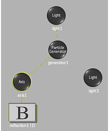

  3. In the schematic, select the Particle Generator.
  4. From the Node bin, double-click the a texture map node.
    A texture is added using the currently selected media and is parented by the particle generator.
  5. Apply the appropriate media to the texture object and set texture menu settings.

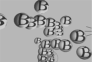

    For example, the following shows the schematic and the result of a particle stream using spheres and a reflection map, making each particle resemble a glass ball.
