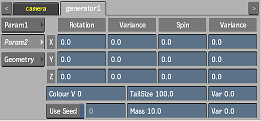

Additional particle generator controls can be found in the Param2 menu.
X Rotation field
Displays the X orientation for particles that have just been born (spawned).
Y Rotation field
Displays the Y orientation for particles that have just been born (spawned).
Z Rotation field
Displays the Z orientation for particles that have just been born (spawned).
X Rotation Variance field
Displays the variation of the X rotation of a particle once spawned from the particle generator.
Y Rotation Variance field
Displays the variation of the Y rotation of a particle once spawned from the particle generator.
Z Rotation Variance field
Displays the variation of the Z rotation of a particle once spawned from the particle generator.
X Spin field
Displays a value to act as a speed setting to an X rotation animated over time.
Y Spin field
Displays a value to act as a speed setting to a Y rotation animated over time.
Z Spin field
Displays a value to act as a speed setting to a Z rotation animated over time.
X Spin Variance field
Displays a variation to the X Spin channel once particles are spawned from the particle generator.
Y Spin Variance field
Displays a variation to the Y Spin channel once particles are spawned from the particle generator.
Z Spin Variance field
Displays a variation to the Z Spin channel once particles are spawned from the particle generator.
Colour Var field
Displays the variation of the colour of each particle based on the colour set in the Diffuse colour bar (Particle Geometry menu).
Use Seed
Enable to override the particle's seed (useful if you want to change the position of each particle in the particle stream).
Seed field
Displays the random seed value for the particle stream properties.
TailSize field
Displays the width of a particle's tail, expressed as a percentage. Works only with quad and cone particle types.
TailSize Variance field
Displays the variation of the TailSize value, as a percentage.
Mass field
Displays the mass of each particle (used with Damping when manipulating particles).
See Setting Manipulator Properties.
Mass Variance field
Displays the variation of the mass, as a percentage.
