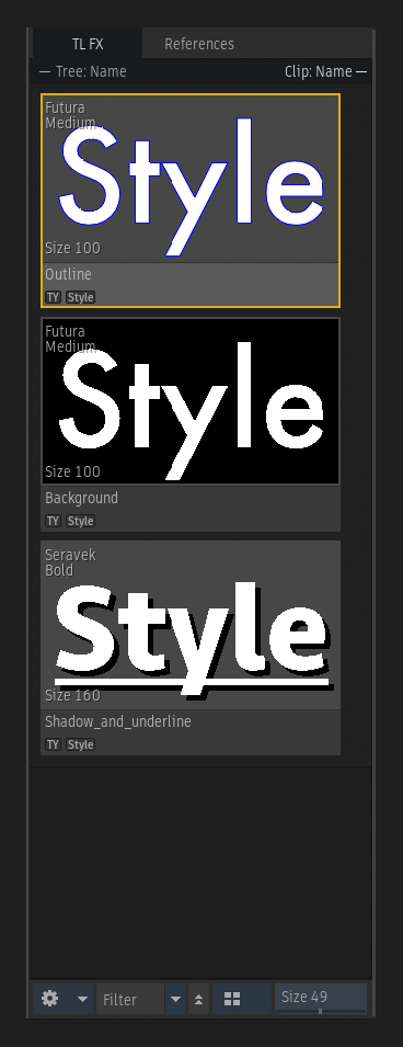

A Type Style can be saved in two places: the Explorer or on disk. The former is useful to apply a style to other text layers in the same project; the latter is useful for storing style presets to be used in any project.
To save a Type Style to the Explorer:
  1. Select the character with the style you want to save.
  2. Open the layer's context menu.
  3. Select one of the options in the Save Style to Explorer submenu.
  4. Optional: Give a name to the Type Style.
    The Type Style is added to the Explorer. The thumbnail shows a preview of the style and Font, Font Style, and Size information.
When you want to quickly apply the character attributes from a Type Style to different characters, select an entire layer or specific characters, and use one of these methods.
To load a Style from the Explorer, either:
  • Double-click on the Style tile.
  • Drag the Style tile to the viewport.
