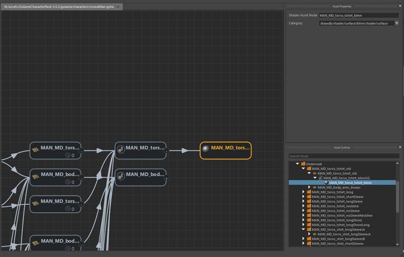

- In the Golaem Character maker Geometry tab select the piece of geometry on which you want to assign the hue variation and select its Shader.

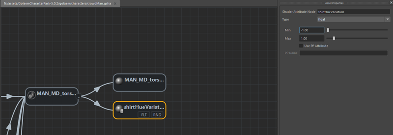

- Drag and drop a Shader Attribute node and link it to the desired shader node,  rename it shirtHueVariation and give it a range of values (-1; 1).
- Don't forget to save your gcha!

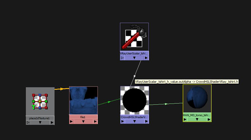

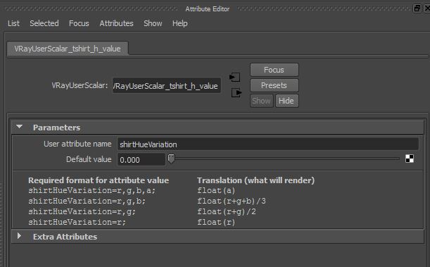

- Go into the Hypershade and link a crowdHSL to your shader Color.
Depending on your renderer the nodes to feed the HSL shader will be different, please refer to the associated documentation to know how to plug them:
Renderer Node to feed the HSL
Vray VrayUserScalar
Arnold aiUserData
Redshift RedshiftUserDataScalar
Renderman Studio PxrAttribute
- In the feeder node (VRayUserScalar for example), query the value name shirtHueVariation.
- Hit render!

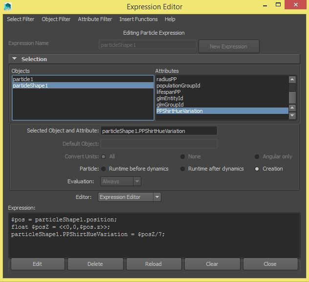

- In the particleShape create a new PP attribute, assuming you want to change the tshirt hue name your new PP attribute PPShirtHueVariation
- Create a little expression to give a range to your Hue variation.

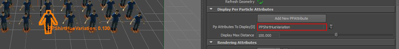

- Check if the PP attribute is working. Go into your entityType Shape and add the PPShirtHueVariation as a displayable attribute.

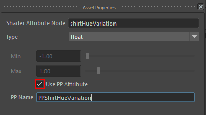

CONFIGURE THE GCHA
- Go back in the Golaem Character maker  Geometry tab and select the previously created Shader Attribute Node.
- In the Asset Properties window check the box "Use value from PP attribute" and query the PP attribute:  PPShirtHueVariation .

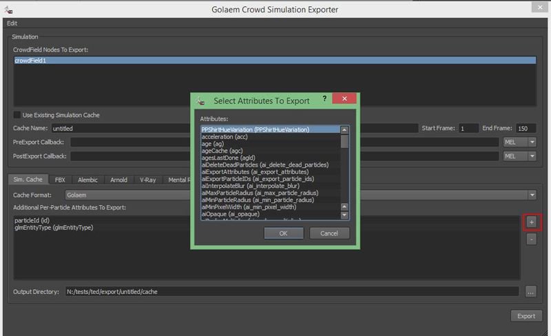

- Finally in the Simulation Exporter, make sure to export the PPAttribute PPShirtHueVariation in the Simulation exporter  (in the Addition Per Particle Attributes To Export section)

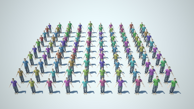

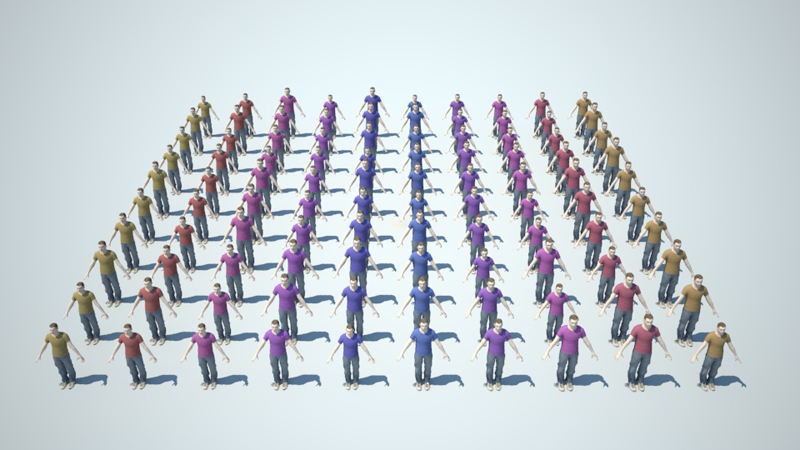

hue controlled by PP attribute
Same process goes to control the Saturation and Lightness of your texture; just plug the feeder node into the corresponding channel (h: hue, s: saturation, or l: lightness) of the HSL shader.
