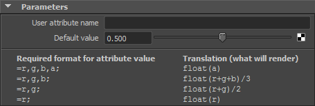

| User attribute name | Name of the user data attribute to read in the rendered mesh and which will be returned. The name of the user data should be the same as the one defined in the Shader Attributes of the Mesh. |
| Default value | Default value to return if the corresponding user data is not found |
