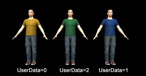

Result of a Get User Data Int Shader combined with a Crowd Switch
Shader and different user data values.

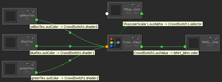

In the following example the Crowd Switch Shader has 3 textures connected to its 3 first Shader slots. Its Selector value is fed by a aiUserData shader and its output is connected to the Color attribute of a Blinn Tshirt shader.

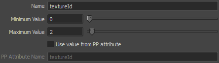

In the Character Maker Geometry Tab, the Tshirt Shader has an Integer User Attribute named "textureId" which will have a random value between 0 and 2 (notice that this value can also be controlled with a ppAttribute) :
Then, the Crowd Get User Data Int is configured to read the parameter "textureId":

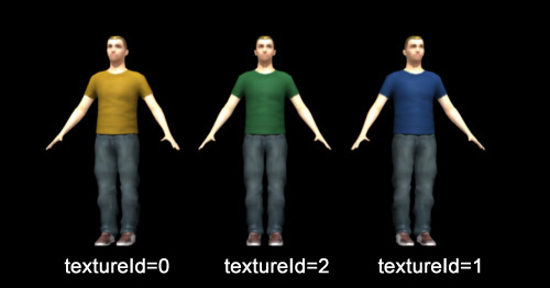

At render time, Entities having this Blinn Tshirt shader listed in their Assets, you get the following result:
