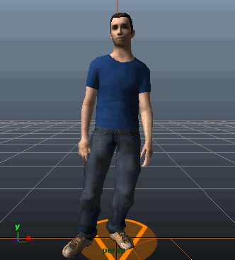

Playing the Stand posture in Interpolated Blend Mode with both Breathe and Clench Fists animations in Additive Blend Mode (Posture & Variations) will then result in a kind of Stand Nervous animation (without needing to configure body masks):
A stand nervous animation

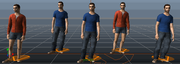

If now considering several characters, Breathe and Clench Fists animations can be configured with some randomness (in attributes such as Speed Ratio, Start Percent or Additive Blend Ratio, and also directly in Behavior Graph with random delays) to obtain a different and unique animation for each character:
Several characters each playing a stand nervous animation

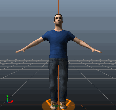

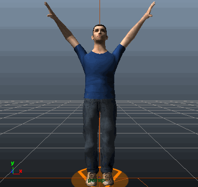

Additive Blend Ratios
Additive blend ratios can be used to accurately control the amount of animation added. For instance, considering the following configuration for the additive animation in the previous example setup in Additive Blend Mode (Posture & Variations):
Main Blend Pass Output Animation
Additive Animations Input/Configuration Additive Blend Pass Output Animation

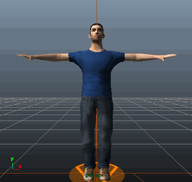

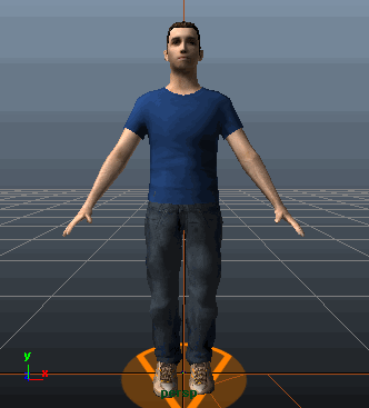

A-Stance
Waving T-Animation
Additive Blend Ratio is 0.0
A-Stance
Waving T-Animation
Additive Blend Ratio is 0.5
A-Stance
Added 50% of Waving T-Animation

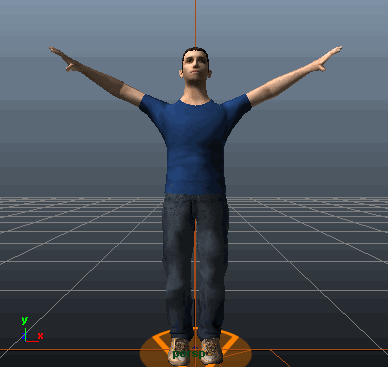

Waving T-Animation
Additive Blend Ratio is 1.0

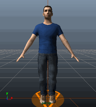

A-Stance
Added 100% of Waving T-Animation
Waving T-Animation
Additive Blend Ratio is 1.5
A-Stance
Added 150% of Waving T-Animation
Warning:
For each body part, the amount of animation added is in fact the value of the Additive Blend Ratio divided by the number of additive animations currently in use on this body part (e.g. the number of MotionBehaviors configured in additive blend mode, using this body part and currently running)
