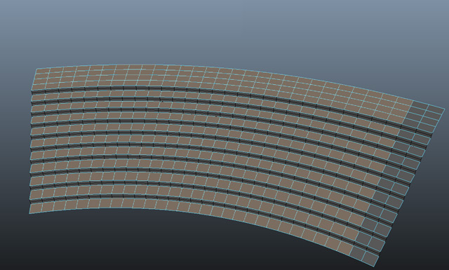

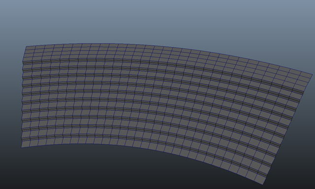

We'll start with an empty stadium stand, subdivided so that a face is more or less the size of a character.

First, set the "Select faces component" selection mode.
Select the stand once, and then select the faces on which you want to place some characters. Note that your selection does not have to be contiguous, you can just select any set of faces you want.
In the following example we want the right-hand side of the stand to be empty in order to create a stair.
Note:
To make sure you won't select the vertical faces while populating, the stadium has been built using two different polysurfaces and the vertical faces surface has its Drawing Overrides / Display Type set to "Reference" (see Attribute Editor) so that it's not selecatable.

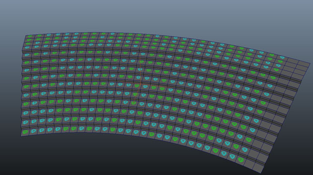

Then click on the Golaem Crowd population tool creator , and select the "Selected object or component" mode  in the Tool Settings panel.

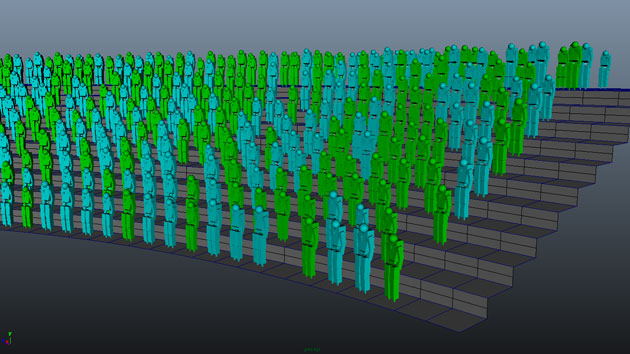

A population tool is created, with one character per face. Notice that no character has been placed on the faces we did not select.

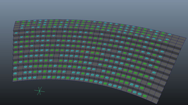

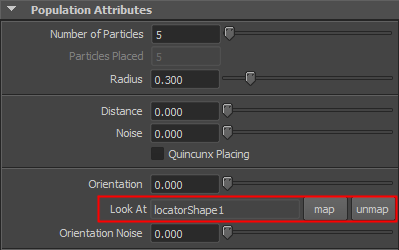

Obviously you can customize the number of particles, the number of characters per face, or even their orientation. For example, in the following picture, we removed a few characters and mapped a locator in the LookAt attribute of the Population Tool Locator.  This is very useful to make all people in the stadium look at the same point of interest (optionally with a bit of noise).

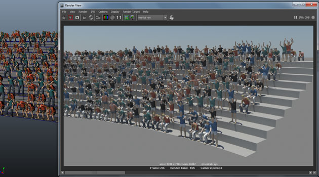

Hit play to see your characters appear.
It's possible to get a better character preview using the Render Previz mode in your EntityTypes.

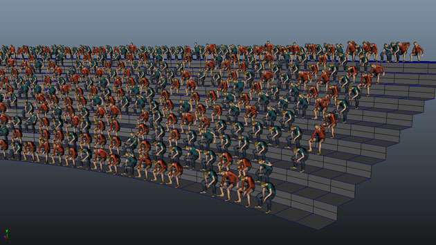

It's simple to create ambiance in a stadium using a few looping motions started randomly.
Open the Behavior Editor, and double click on your first EntityType. A tab appears, corresponding to the behavior of the characters from this EntityType.
Drag and drop a MotionBehavior on the Behavior Life arrow.

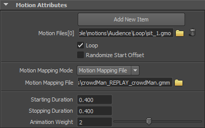

Select it and check your Attribute Editor. The main attribute is a list of motions that should be played. Click the folder icon and browse to a looping motion.
You also need to select a Motion Mapping File, or to set a different Motion Mapping Mode (depending on your character and motions, see Motion Mapping)
This motion list typically contains only one motion, which is the motion you want the characters to play. However, if you add more motions by clicking the "Add New Item" button, one motion will be randomly chosen each time the behavior starts. This can help you to easily add animation diversity to your stadium.
Repeat the same operation with the second EntityType and run the simulation.
As we used only one motion and the characters all start at the same time, there is no animation diversity at all. Just go back to the Motion Behavior attributes and check "Randomize Start Offset".

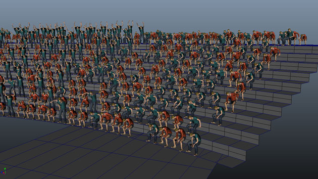

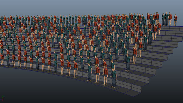

Creating A Wave In The Stadium
In order to create a wave effect, we need to trigger a stand up and raise arm motion progressively in the stadium.
We're going to take advantage of Golaem Crowd motion blending capacities.

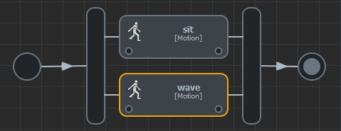

Go back to the first EntityType behavior, create a parallel operator and insert the sit MotionBehavior inside
Insert another MotionBehavior in the parallel operator, we will use this one for creating the wave

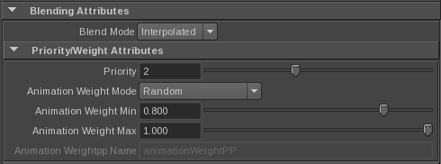

Add a wave motion to the motion list of the created MotionBehavior. Set animation weight min to 0.8 and max to 1.0. This will enable the wave motion to be fully played over the sit motion when started. The sit motion will be playing in the background, ready for blending back when the wave motion ends.

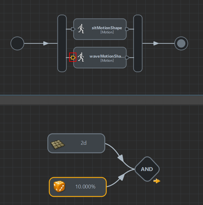

Let's configure the wave motion start trigger, so that it starts only when wanted.

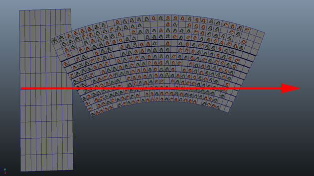

Create a plane and set keyframes to make it pass under the characters and come back.
Select the plane and map it in the zone attribute of the wave MotionBehavior Start Trigger (See Mapping objects to triggers/behaviors). You can also check the random trigger to add some more diversity.
Wave Behavior StartTrigger
The wave MotionBehavior is now triggered when the plane passes under the characters.
Hit play, and characters now do the wave when the plane first passes under them.

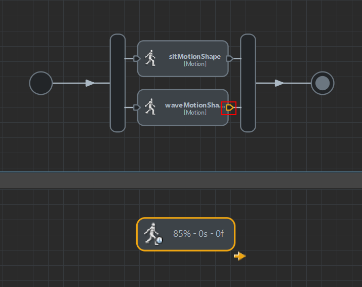

Then, to avoid the wave motion playing infinitely, you'll need to set a stop trigger. Click on the right-hand side circle of the wave MotionBehavior, and set a motion time trigger at 100%. Don't forget to uncheck the false trigger.
Wave Behavior Stop Trigger
Rendering
See Using The Sample Files to learn how to automatically configure the sample for rendering.
For more details, check the Rendering section.
