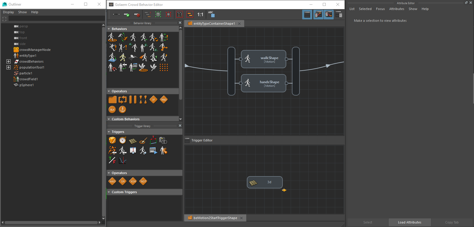

1. Open the Behavior Editor and the Trigger Editor, and make the Behavior or the Trigger visible, but DO NOT select it yet.

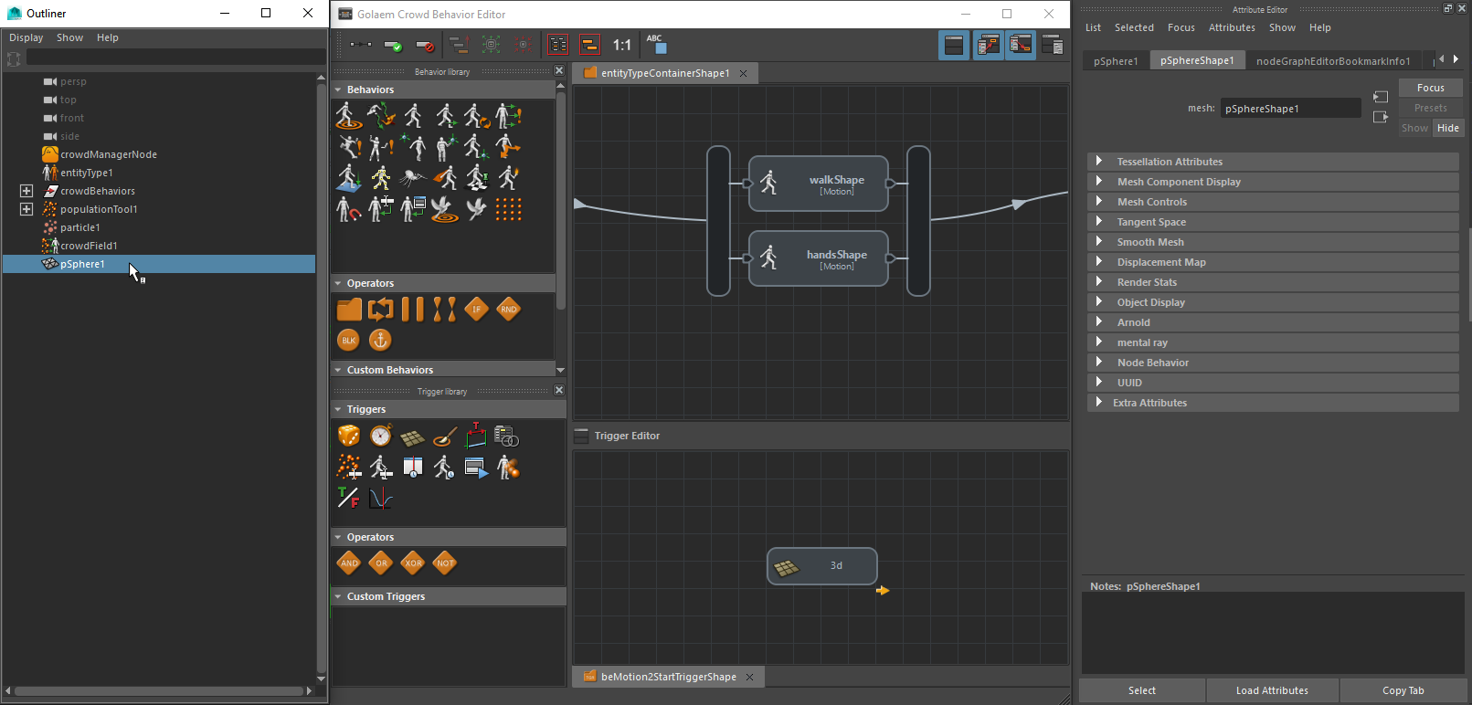

2. Go to the outliner and select the object to be mapped

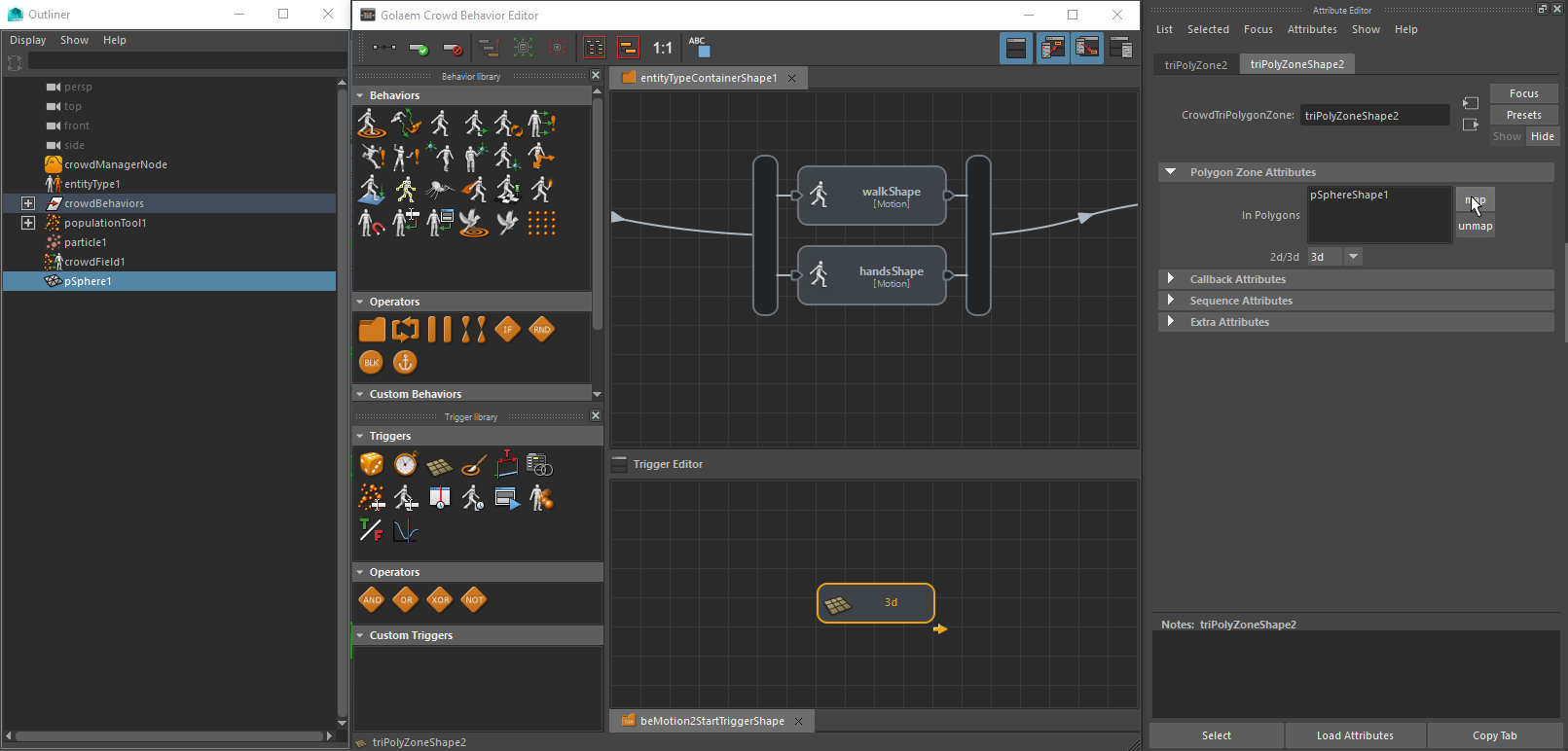

3. While holding the SHIFT key, select your Behavior in the Behavior Editor or your Trigger in the Trigger Editor
4. Click on the map button it the field to be mapped in the attribute editor (here Polygon Zone Trigger)
