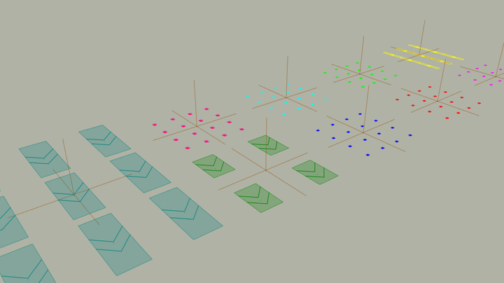

The Population Tool Locator provides an easy way to place Golaem Entities in the scene. Each Entity will be given a position, direction and an Entity Type. The Population Tool Locator has several parameters to specify the population like Entity Type weights in the population, distance, noise…). The Population Tool Locator generates Maya particles or nParticles, which store all the data necessary to spawn the Golaem Entities when initializing the crowd simulation.
The Population Tool locator can be mapped to a Terrain Locator. In this case, Entities Y position will be adapted according to this terrain.

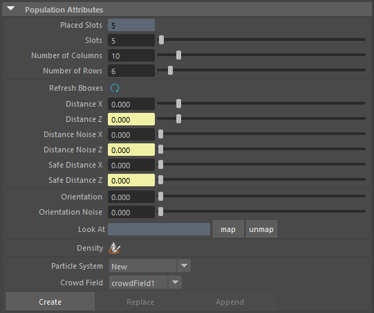

Population Attributes
This panel contains parameters to precisely manage the slot placement in the locator.
The slot size is the bounding box of the Perception Shape, which is defined in the Character Maker and can be overridden with any geometry in the Entity Type node Perception Attributes. Slot size also takes into account the mean scale defined in the Entity Type Character Attributes and the Entities Scale in the connected Crowd Field or in the Crowd Manager Node if the Population Tool is not connected to a Crowd Field.
Placed Slots Actual number of slots placed in the area. It can be different from the number of slots if a Terrain Node with a NavMesh has been assigned to this locator and there's not enough space to fill the Population requirements (size, distance between slots)
Slots Number of wanted Entities. Notice that if the zone is too small or contains too many obstacles, it is not always possible to generate the wanted number of slots.
Number of Columns Number of columns of the area. This attribute are editable only with the center point shape, by updating the size of the grid. With other shapes, it's an information about the size of the computed grid.
Number of Rows Number of rows of the area. This attribute are editable only with the center point shape, by updating the size of the grid. With other shapes, it's an information about the size of the computed grid.
Refresh Bboxes Trigger a manual refresh of the Perception bounding boxes in all the Population Tools. This is useful when Perception Bounding Box is edited in the Character Maker or the Character file is replaced in the Entity Type.
Distance X / Z Distance between slots. A negative distance brings slots even closer together.
Distance Noise X / Z Position noise of Entities. For curve population tool, will noise X in curve tangent direction, and Z orthogonally.
Safe Distance X / Z Distance to add around the slots to prevent them from getting any closer to other slots. The Safe Distance parameters are in the slot's local coordinate system.
Orientation Orientation of Entities
Orientation Noise Orientation noise of Entities
Look At
Modify the orientation of Entities to look at a Locator
Look at orientation
Density  Open the Paint Tool to paint the Population density
Particle System
Choose "New" to create a new Particle System, or select a Particle System from the scene to replace or merge it with current particles.
Crowd Field
Choose "New" to create a new Crowd Field, or select a Crowd Field from the scene to link with the created / replaced particle system. Is it also possible to choose "None" to emit particles which will not be assigned to a Crowd Field. A Crowd Field can also be created afterwards if required (see Crowd Field documentation).
Create When you get the wanted repartition, press this button to create a new Particle System. The Particle System will be fed with an initialization positions, directions, Entity Types and other requested attributes
Replace/Append
Replace or append the Particle System selected in the previous combo box with the new one. Notice that replacing a Particle System will preserve existing connections and expressions.
Several Population Tool Locators selection
When you get the wanted repartition in several Population Tool Locators, select them and press the Create button to create a new Particle System containing relative particles. Replace or append the Particle System previously selected in the Combo Box with particles from the selection.
Create, replace or append particles from selected Population Tools Locators

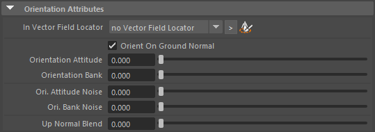

Orientation Attributes

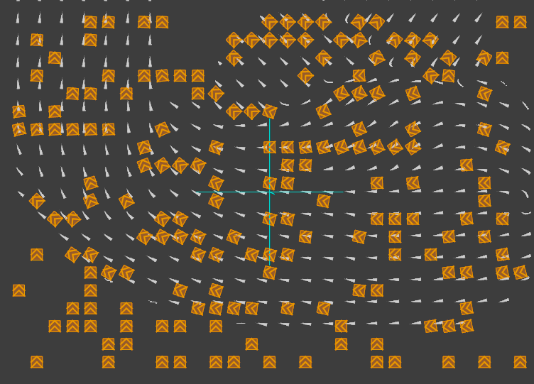

In Vector Field Locator
Vector Field attached to this Population Tool. The Vector field will be used to orient the slots. Select the Vector Field with the combo box. Painting in the selected Vector Field will automatically update the slots orientation.

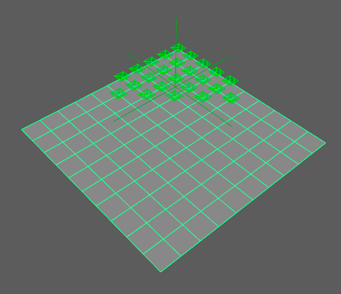

Population Tool slots without and with Vector Field.
Orient On Ground Normal The slots up vector is generatedaccording to its support normal
Orientation Attitude Modify the orientation attitude of Entities
Orientation Bank Modify the orientation bank of Entities
Orientation Attitude Noise Adds random noise to attitude
Orientation Bank Noise Adds random noise to bank
Up Normal Blend In some cases, it is preferrable to blend the support normal with the default 'up' vector (grass, trees on a sloppy ground) to get a proper slot normal.

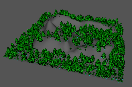

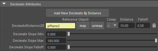

Decimate Attributes
Decimation offers different ways to limit the population slots output, either by distance to an element or a slope criterion.

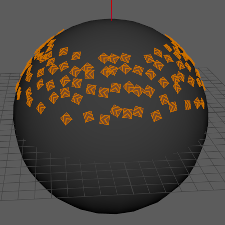

Decimate by distance to the selected plane on top of view, on a grid population tool, for example: the audience of a concert
Decimate by slope: for example, some vegetation only growing at these slopes.
Add New Decimate By Distance Adds a new decimate by distance entry
Reference Object Map a VERY low poly mesh (2 triangles plane, simple box, low poly cylinder), then each slot can be decimated based on its distance on the closest triangle of the mesh. Beware that each slot will be tested against each mesh triangle to get its closest distance, thus performance depends greatly on the bound mesh.
Comp Comparison operator: ">" - decimate slots which are farther than the Distance value, "<" - decimate slots which are closer than the Distance value
Distance Distance at with to start decimating
Falloff Adds an additional, linear falloff on the given distance, where slots will not get decimated. The closer the slot is to the limit distance, the greater the chance that it will not be decimated.
Decimate Slope Min Minimum angle with the up axis of kept slots (0-180 degrees). This parameter is only available when Orient On Ground Normal is enabled.
Decimate Slope Max Maximum angle with the up axis of kept slots (0-180 degrees). This parameter is only available when Orient On Ground Normal is enabled.
Decimate Slope Fall Off Adds an additional, linear falloff out of slope bounds, where slots will not get decimated. The closer the slot is to the limit slope (min or max), the greater the chance that it will not be decimated. This parameter is only available when Orient On Ground Normal is enabled.

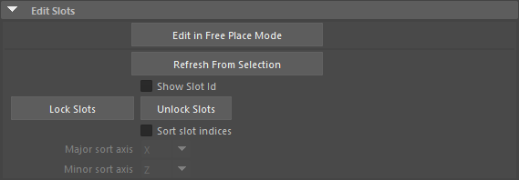

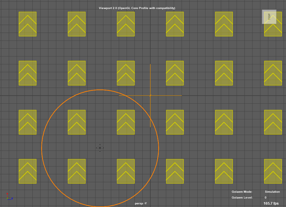

Edit Slots

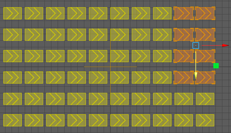

Edit Slots in Free Place mode (left) or in UV Mode (right)
It is possible to edit Population Tool either using the Population Tool Free Place mode or in Maya's UV mode using Maya Translate, Rotate and Scale manipulators.
  • To go to the Population Tool Free Place mode, click the Edit in Free Place Mode button
  • In Maya UV Mode (F12), select one or more slots in the Population Tool Locator, enable Maya Translate Tool (W), Maya Rotate Tool (E) or Maya Scale Tool (R) and use the gizmo to move, rotate or scale the slots. To reset the slots position to their original positions / orientations, set the Slots count to 0 and reset it at the previous value
Edit in Free Place Mode Open the Population Tool in Free Place mode to edit the Population Tool Locator slots.

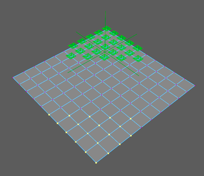

Refresh From Selection Refresh positions of Slots that have been created on object components by selecting both the population tool slots and the components and hitting this button
As Maya selection for components of different kinds can be a bit tricky, here is the order of selection that will work:
  • start by selection the population tool slots in param point component (F12)
  • hold shift key and click on the object to select components from
  • switch in the correct component mode (point/edge/face)
  • hold the shift key and click on the components to add on selection
  • hold the control key and click on the population tool node from the outliner
  • click 'Refresh From Selection' button
Show Slot Id Display the Id of each slot
Lock Slots Lock the selected slots. A locked slot will be displayed with dotted lines .
A locked slot is not affected by the placement attributes updates, its position and orientation are locked. However if the total number of slots is not sufficient to place this locked slot, it will be removed.
Unlock Slots Unlock the selected slots. Unlocked slots will be displayed with continuous lines
Sort slot indices Sorts slot indices according to an axis (useful to allocate targets slots to specific entities)
Major sort axis The slots will first be sorted against this axis
Minor sort axis If several slots share the exact same major axis value, minor axis is used to further order them.

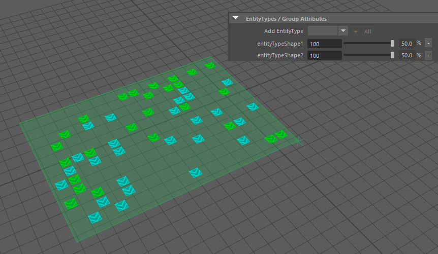

EntityTypes / Group Attributes
This panel defines which Entity Types will be assigned to the emitted particles. Notice that Entity Types previously selected in the Population Tool Context are present in this layout.

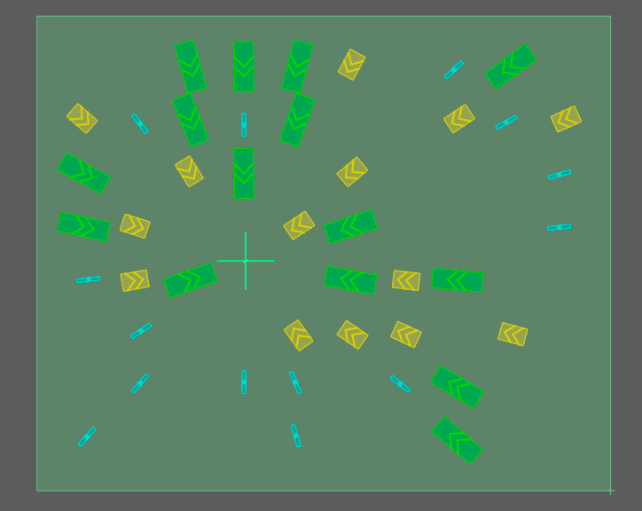

New Entity Types can be mapped by selecting them in the Add EntityType combo box and then clicking on the add button . To add all Entity Types, click on the button. To remove an Entity Type just click on the related remove button . Remove all Entity Types with the Remove all EntityTypes button.
Each selected Entity Type has an attribute defining its weight relative to other mapped Entity Types. The ratio of Entity Types in the Population Tool Locator will be affected by changing the weight attributes.
Illustration of the use of Entity Types during the placement step with different weights
Note:
Notice that Entity Types distribution is influenced by the placement seed and the Crowd Manager random seed.
Note:
Notice that Entity Types can also be painted on the Population Tool with the Paint Tool.
Enable random shuffle Add randomness to the Entity Type distribution. The Entity Type sequence is randomly shuffled.
Enable Random Shuffle off (left) vs Enable Random Shuffle on (right) on a face component Population Tool

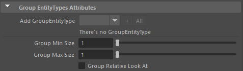

Group EntityTypes Attributes
This panel defines which Group Entity Types will be affected to the emitted particles.
As with EntityTypes, the ratio of Group Entity Types will be affected by changing weight attributes.
Group Size Attributes
Group Min Size Entities will be grouped by at least this value
Group Max Size Entities will be grouped by a maximum of this value
Group Relative Look At When enabled, the entities will look at their group center. If needed, an offset can be defined by the difference between the scene origin and the main 'Look At' locator position (taken as a relative offset from origin for each group)
By using these attributes, you will be able to group several Entities inside a Population Tool Locator. The same Group Entity Type will be used by the Entities inside a cluster.
Illustration of Group Size Attributes (min:3 and max:5)

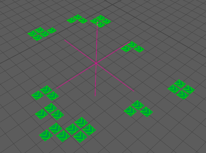

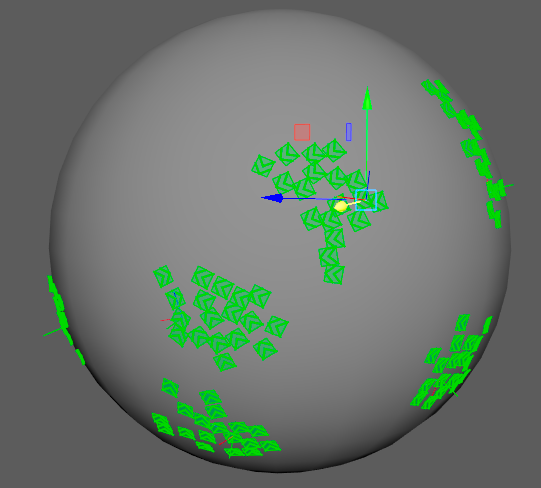

Scatter Attributes
Only used with a scatter mode populate on selection (). The scatter attributes give the min/max samples picked around a random position before changing it. If min and max are 1, the population is completely generated from the first randomly picked position.
Scatter Seed Count
Controls the number of different random seeds (picked randomly on surface), which will generate as much manipulators. The total count of slots will be evenly spread between all seeds.

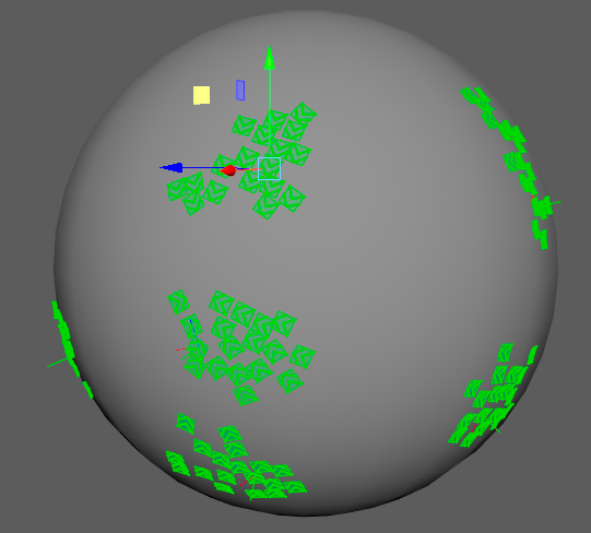

Manipulators can be found under the outliner, parented to PopulationToolLocator :
Seeds manipulators parented under the population tool locator
They can be moved to modify the seed location:
A seed moved on a scatter population tool locator
Scatter Clustering Min The minimum number of samples generated via poisson disc method, before changing of random position
Scatter Clustering Max The maximum number of samples generated via poisson disc method, before changing of random position

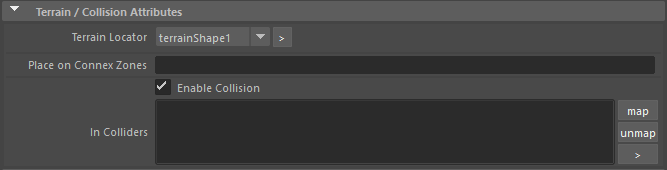

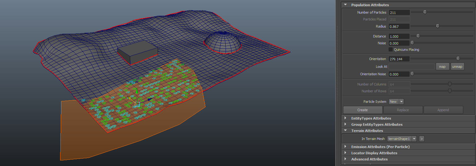

Terrain / Collision Attributes
Terrain Locator
Terrain Locator attached to this Population Tool. The Terrain locator will be used to make the locator slots adapted to the terrain. Select the Terrain with the combo box. If you don't want the slots to be adapted to the Terrain, just unlink it.
Place on Connex Zones Slots are only placed on the specified navmesh connex zones. See the Terrain Locator for more information about Connex Zones.
Enable Collision If checked, slots in collision with slots of Population Tools listed in the In Colliders attributes will not be placed
In Colliders
Population Tools to consider slot collisions with. By default, Population Tools sharing the same Terrain Locator will be automatically added as Colliders.
Check Self Overlap When enabled, the Population Tool removes Slots that overlap

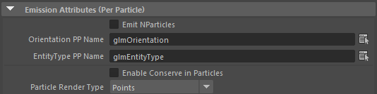

Emission Attributes (Per Particle)
This panel defines per-particles emission attributes of the Population Tool Locator.
All per-particles attributes will be exported in the wanted Particle System. If a per-particles attribute does not exist, it is automatically created.
Emit NParticles Emit this Population Tool Locator in a nParticle System
Orientation PP Name Name of the vector per-particle attribute in which the orientation of the Entities will be exported.
EntityType PP Name Name of the float per-particle attribute in which the Entity Type of the Entities will be exported. The Id of an Entity Type can be found in the attribute editor of the EntityType
Enable Conserve In Particles Enable or disable the conserve attribute in the wanted particle system
Particle Render Type Select the particle render type of the wanted particle system

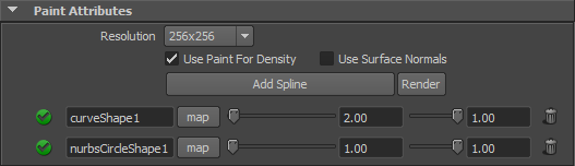

Paint Attributes
Resolution Resolution of the painted map. This goes from 256x256 to 4096x4096. Changing resolution resamples the map. Bigger map takes longer to save and uses more memory.
Use Paint For Density This attribute is activated automatically as soon as the Paint Tool is used to paint slot density on the Population Tool Locator
Use Surface Normals If Use Surface Normals is enabled, a dot-product is made between the surface normal and the vector between the surface point and the closest spline point.

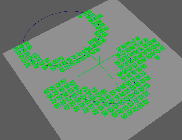

Add Spline Add a spline free slot where you can map a spline and specify its rendering attributes
Render
Rendering splines will erase the surface if at least one spline is enabled
Spline Attributes
  • Enable/disable check
  • Mapped spline
  • Radius around the spline that will influence surface
  • Paint intensity/slots density
  • Remove spline button

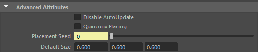

Advanced Attributes
Disable AutoUpdate Disable the automatic update of slots, useful when using heavy population tools with decimate or collision attributes which take a lot of time, to save performance while batch-changing attributes.

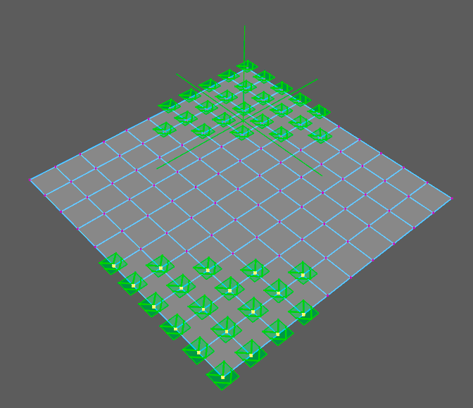

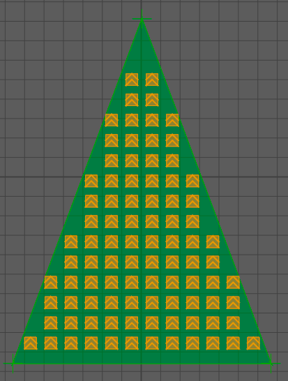

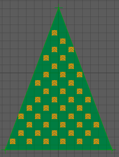

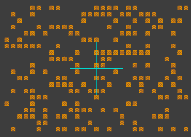

Quincunx placing Use a quincunx shape for particles placing
Without quincunx placing and with quincunx placing
Placement Seed Value used to initialize the current Population Tool Locator seed in addition of the Crowd Manager random seed. Changing this value has an influence on the Entities placement, but only in this Population Tool Locator.
Default Size Default size to use for the slots in X, Y and Z axis, when there is no Entity Type or the mapped Entity Type has no character file.

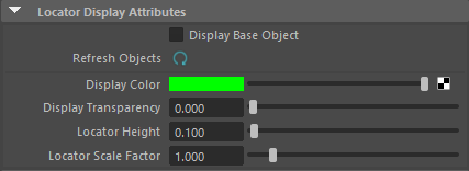

Locator Display Attributes
Display Base Object
Activate the preview of the chosen entity types in addition of the slots, to have a look and feel feedback. Note that asset repartition and scales of the produced entities may differ. It is only for a quick preview purpose, and only active in the viewport. The crowd field generation IS mandatory to render the entities.
Display of a tree scene populated via scatter + slope decimate, with 'display base object' option active
Refresh Objects If the entity types assets are changed, you may need to use this to refresh the population tool preview.
Display Color Color of the Population Tool. This is also applied in the Outliner
Display Transparency Transparency of the locator
Locator Height Height of the Population Tool Locator for display only. Particles will still be generated on the terrain
Locator Scale Factor Scale factor to apply to the locator display

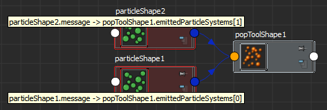

Relationship between emitted Particle Systems and the Population Tool Locator
When a particle system is emitted from a Population Tool Locator, a link is created between the two objects. This link can be used to retrieve which Population Tool Locator has been used to emit one particle system.
Relationship between emitted particle systems and their Population Tool Locator
When a particle system is emitted from a Population Tool Locator, some special Per-Particle Attributes are created and set automatically. If some of those Attributes do not exist, Golaem uses default values. The created Per-Particle Attributes are the following:
