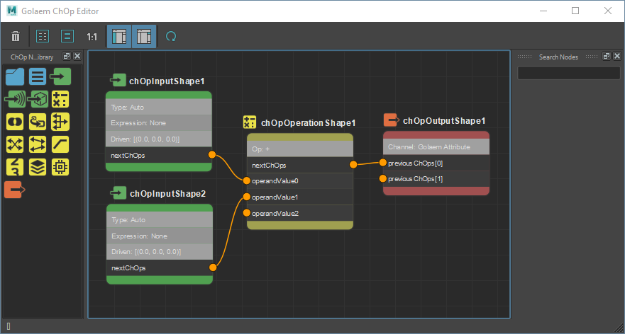

Channel Operator Editor Overview
The Channel Operator Editor lets you manipulate the graph of Channel Operators that are available in the scene.
The Golaem Channel Operator Editor displaying a graph with a few
Channel Operators

Workspace
Tool Bar
Tool Bar
The tool bar lets you clear a graph (bin icon), frame all or selected, zoom at a 1:1: ratio, enable or disable search box and nodes library, and force a refresh from Maya nodes.
Search Box
Search Nodes Box
The search nodes Box lets you highlight all nodes starting with the given string. It handles the * wild card as start, and is NOT case sensitive.
Nodes Library
The Nodes library let you drag and drop Channel Operator nodes directly from the editor (see the Channel Operators Overview for nodes type)

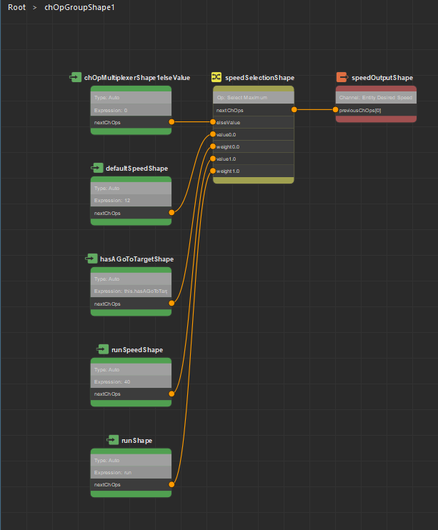

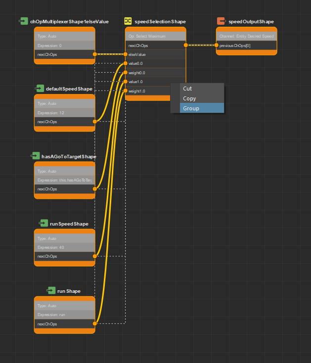

Grouping
You can group or ungroup, or even use nested groups, to organize your work. Here is an example of a graph ready to group (select and right click / group) :
Nodes ready to be grouped
Grouped Nodes under main view
Inner view of a group node : a clickable navigator link is added on the
top left, to navigate up to parents

- Nodes can be grouped by selecting a whole graph (select + right click, group). They can be ungrouped by selecting the group and chosing 'ungroup'
