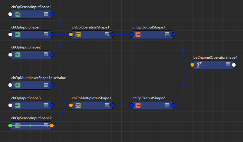

An example graph of Channel Operators, with two outputs (in orange)
connected to a Channel Operator Behavior

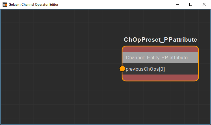

- you can also create new nodes in the Golaem Channel Operators user interface by hitting the Tab key, and typing the name of the Channel Operator to create. Channel Operators can then be connected by clicking on the orange connection disc of a node and holding the mouse button while moving the cursor to the next orange connection disc.

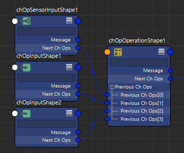

Channel Operators are connected together via their NextChOp output plug and PreviousChOps input plug array.
Channel Operators connections
Depending on its type, a Channel Operator may use the value of only one or several Channel Operators connected to the PreviousChOps plug array to compute its own value, and the index of the connection might change how its value is used. Check out the documentation for each Channel Operator for more details.
