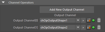

Channel Operators
Output Channel
List of output channels that are used by the behavior.
Click on the combo box to select another existing output channel, on the right arrow to select the output channel node.
Use the "Add New Output Channel" button and the trash icon to add or remove expressions.
Use the  button to open the Channel Operator graph for this Output Channel in the Channel Operator Editor.
