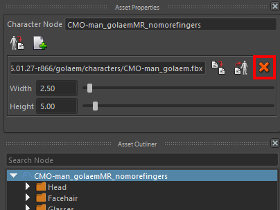

- Select the Character Node in
main workspace, and remove its Geometry File in the Asset Properties panel by clicking on
the
button. It may be a good idea to
write down the current Bounding Box values, as they will be needed
afterwards.
- Click on the Export geometry file
button, and save the new .fbx
to the /crowd/fbx directory. - Change the Bounding Box Width and Height of the created Geometry File (you can check the bounding box size in the viewport). They should be similar to the previous ones, or bigger if the modified props are outside the previous bounding box

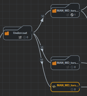

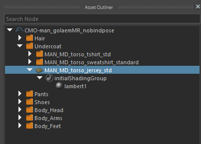

in the Geometry Tab - A new Mesh Asset node is added to the selected Asset Group node. The shaders of the mesh are also imported as Shading Group nodes, Shader Asset nodes and Shader Attribute nodes (if found)
New Mesh Asset node in the main workspace and in the Asset Outliner

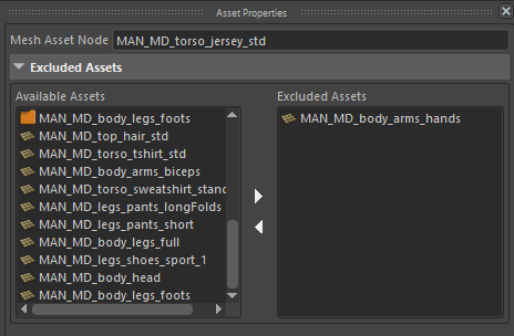

- If needed, add incompatible meshes or groups as Excluded Assets
