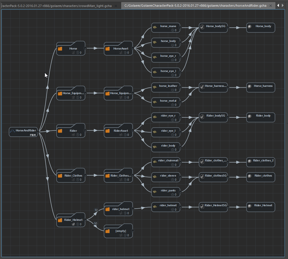

Here are the types of Geometry Asset Nodes:
Name Icon Main Workspace Representation Description
Character Node
This is the root node for all the geometry assets. There must be one and only one Character Node. All other geometry asset nodes must be connected (directly or indirectly) to this node to be taken into account.

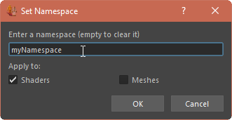

  • Set Namespace...: apply a namespace to meshes and/or shaders. This opens a dialog allowing to enter a namespace (see image below). The user can choose to apply the namespace to Shaders (includes Shader Assets and Shading Groups) and/or Meshes. This prefixes their names with the entered namespace followed by ":". This can be useful when dealing with references in Maya.
Asset Group Node
An Asset Group Node represents a group of assets. An Asset Group can contain any number of Asset Groups, Mesh Assets or Fur Assets. If an Asset Group is weighted, only one of its child nodes will be chosen at render time according to the asset group's weights, otherwise all of its child nodes will be chosen. An Asset Group node can only be connected to another Asset Group node or to the Character Node.

Mesh Asset Node
A Mesh Asset directly represents a Maya mesh associated to the Character. A Mesh Asset node can only be connected to an Asset Group node. It can contain one or more Shading Group nodes.

Shading Group Node
A Shading Group Node represents the name of the shading group applied on a mesh of the rendered geometry or a fur asset. Each Mesh Asset or Fur Asset node can have one or more Shading Group nodes attached to it. A Shading Group node can only be connected to a Mesh Asset or Fur Asset node. Depending on the renderer, Maya must contain either the shading group or its shaders, otherwise the corresponding meshes or fur assets will be rendered with the default shader (for more info, see the rendering workflow). Shading Group nodes can also contain one or more Shader Attribute nodes.

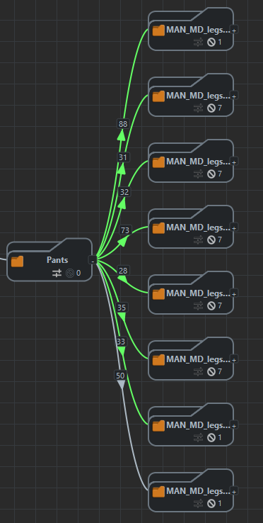

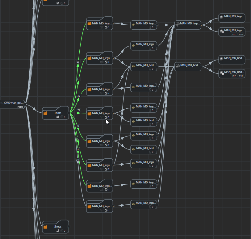

Asset Group Weights
Weighted Asset Groups display the weights of their assets as text boxes on the links to their child nodes. The displayed weights depend on the Rendering Type selected in the Rendering Types Panel. If no Rendering Type is selected (or the root "Rendering Types" item is selected), the weights displayed are the default weights. They are all displayed in white. If a Rendering Type is selected, the weights displayed are the weights in that Rendering Type. The weights it overrides are displayed in green. To change the weights of a Rendering Type, make sure it is selected in the Rendering Types Panel. Then click on a weight box and drag upwards to increase the weight, or drag downwards to decrease it. Weights can also be changed directly in the Rendering Types Panel with sliders, or by selecting an Asset Group node and editing the sliders in its properties panel.
Asset Group weights in the Main Workspace

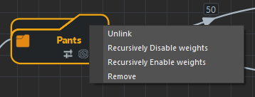

Enable/Disable weights
When a Geometry Asset Node has children, it can behave as a simple group or as a weighted group. It can be tedious to enable or disable this weighting ability on a complex tree. In that case, you can enable or disable recusively the weights on all children of a Geometry Asset Node.
Enable/Disable weights on all children recursively, with the asset node contextual menu
