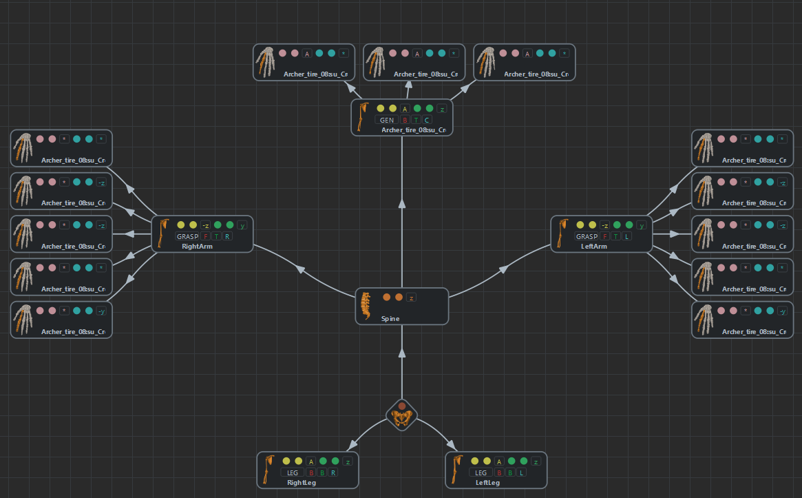

When in the Motion Mode, the Main workspace displays a recreated Skeleton Mapping that matches the loaded Motion file. This is by no means the original Skeleton Mapping that was used to create the Golaem Motion, but only a generic representation that is mostly useful for Motion Mapping, as it keeps the original Pelvis, Spine, Limb and Effector nodes. The Skeleton joints are different.
Original Skeleton Mapping (left) and recreated Motion file recreated
Skeleton Mapping (right)
