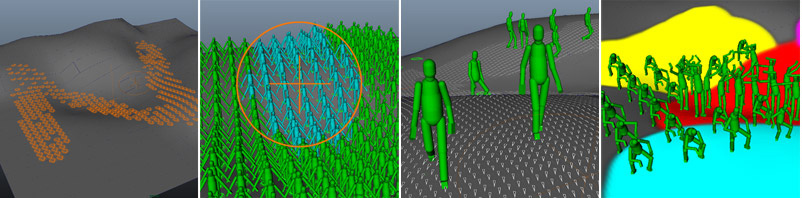

The Paint Tool Context provides an easy way to paint Crowd related objects in Maya (Population Tool slots, Entity Types, Behavior Triggers, Vector Fields...)
Example of paintable Crowd objects: Population Tool slots,
PPAttributes, Navigation Vector Fields, Behavior Triggers

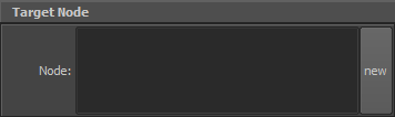

Target Node
This panel defines in which node the data will be painted. Its value changes depending on the selected Paint Mode:
| Node | Defines the node in which the data will be painted:
| New button | Creates a paintable node (either a Population Tool Locator, a Vector Field Locator or a Painted Zone locator depending on the Paint Mode). This button is not available for the PPAttributes mode (but you can use the Population Tool to emit particles) Caution:
To be able to create a new node, a Maya polygon must be
selected first. The Maya polygon will be used to compute the underlying
painted texture.

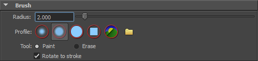

Brush
This panel defines the attributes of the paint brush:
| Profile | Determines the shape of the area affected by the selection (see Maya Artisan documentation) |
| Tool | Defines if it is a paint or an erase session. |
| Radius | Defines the radius for the brush. The radius valus can also be controlled with an hotkey (press b and drag the left mouse button) |

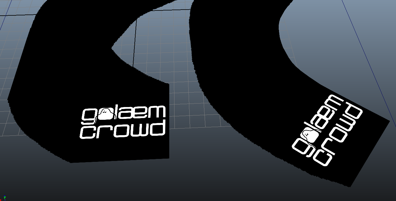

| Rotate to stroke | Rotate the brush according to the brush movement
A brush stroke without and with Rotate to stroke enabled |

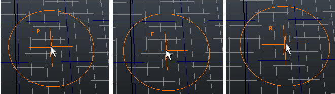

Notice that the Brush cursor display the current mode.
Paint, Erase and Resize Brush cursor

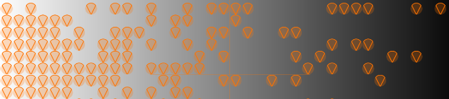

| Color | Determines the density of the slots (the whiter the color, the more dense the slots). The density is stored in the red channel of the painted texture. |
| Opacity | Not used yet |
Density of the slots depending on the painted color

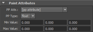

PPAttributes Mode
| PP Attribute | Name of the PPAttribute in the currently selected particle system to paint |
| PP Type | Painted component type (float or int) |
| Min Value | Min value to paint (either a single or a vector value) |
| PP Value | Max value to paint (either a single or a vector value) |

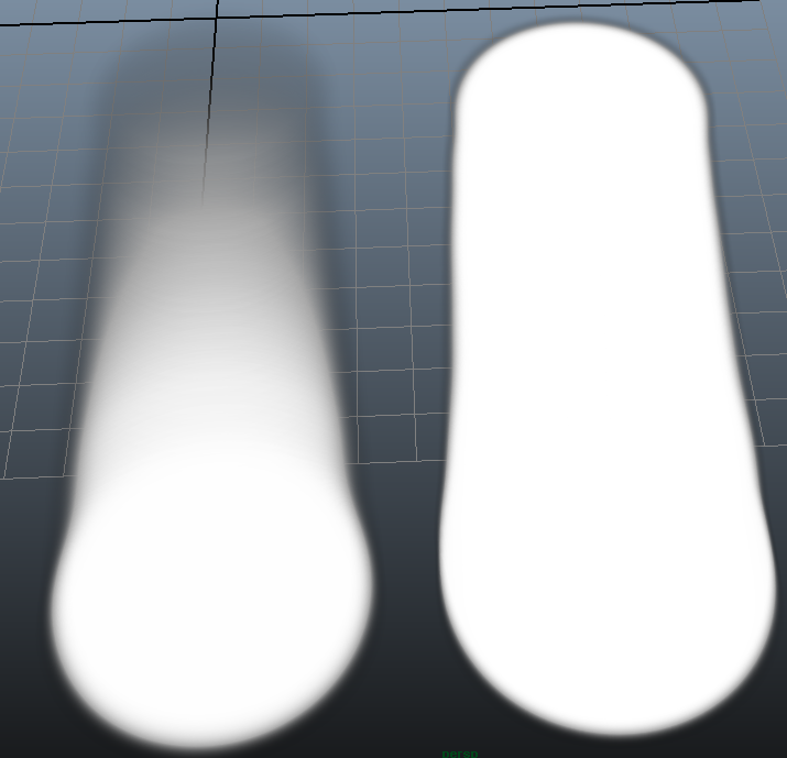

| Delay | Amount of time in second before the brush reaches full opacity.
A delay of 1 second on the left compared to a delay of 0 second on the right |
