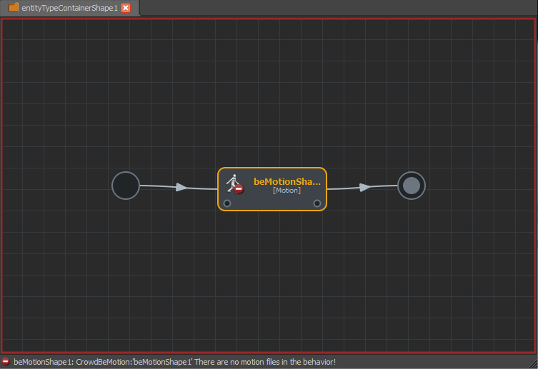

Error | ![]() |
the Behavior is not able to be run and will be removed from the simulation. ![]() Error raised by a beMotion Example: a beLocomotion without any Animation Files |

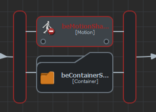

Notice that Behavior Containers, Parallel Operator and No Order Operator status depends on children status. It means that if a child Behavior has raised an error, the parent Behavior Container will also tagged as in error. In this case the Behavior Container will not be removed from the simulation, only the failed child Behavior.
Error raised by a beMotion in a Parallel Operator
