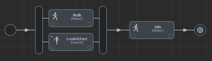

The following example describes a Parallel Operator used to animate an Entity by playing a Walk animation (using a Motion Behavior) and looking at its feet (using a LookAt Behavior) in the same time, then playing an "Idle" animation (also using a Motion Behavior). Considering that the "Walk" Behavior stops after a given a duration and the "LookAtFeet" Behavior has no Stop Trigger, it is necessary to set the "As soon as one behavior has ended" exit mode of the Parallel Operator to run the "Idle" Behavior; otherwise, if using the "When all behaviors have ended" exit mode, the LookAtFeet Behavior will keep running and the "Idle" Behavior will never start (so the entity will be looking at his feet without playing any animation).
A Parallel Operator used to animate an entity with a Walk motion while looking at its feet in the same time (then playing an Idle animation)

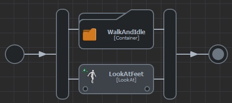

To keep the entity looking at its feet while playing Walk then Idle animations, run the LookAtFeet Behavior in parallel with a Behavior Container, which handles both Walk and Idle animations.
A Parallel Operator used to animate an entity with a Behavior Container handling animation while looking at its feet in the same time

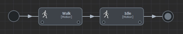

The Behavior Container playing the Walk and Idle motions
