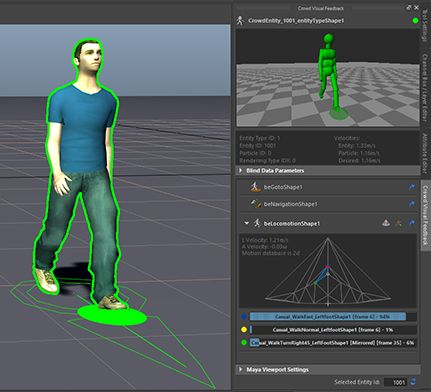

- In Maya Viewport, pick an Entity in the viewport to perform the selection and open the Crowd Visual Feedback focused on the selected entity.
The selection is consistent between several simulations, click outside the Entity to release the selection or change the selected Entity by setting the Entity Id in the "Select Entity Id" editor.
Notice that the bounding box used to perform the selection is the bounding box of the Perception Shape, which is defined in the Character Maker and can be overridden with any geometry in the Entity Type node Perception Attributes. To check what's the picking bounding box of the Entity, switch the Display Mode of the Entities to Bounding Box.

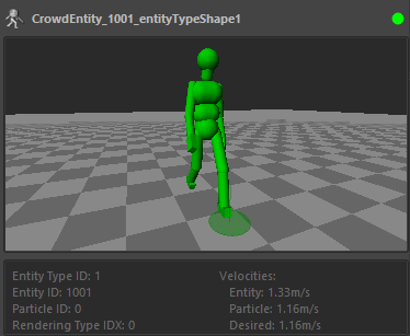

Selected Entity Overview
This panel contains the overview of the selected entity with a dynamic preview of the entity animation in its environment, a bunch of information of the picked Entity and its related particle (Ids / Velocity). The blend shapes values played in the animation at the moment are shown under the Blend Shapes Parameters panel.

Entity Behaviors
This panel contains the running behaviors of the picked Entity and their relative visual feedback.

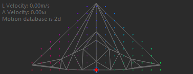

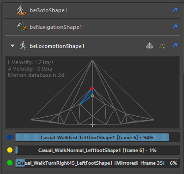

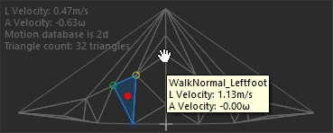

Locomotion Behavior and Navigation And Locomotion Behavior Visual Feedback
The Locomotion Behavior, as well as the Navigation And Locomotion visual feedback shows the Locomotion Model and the Motion Clip related to this model.
Some info on the locomotion database are written on the upper left corner (for instance, you can check the triangle count to ensure there are no flat triangles in the database).

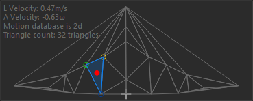

There are four dots displayed on the base:
- the red dot represents the current values of linear and angular velocities computed by the locomotion behavior
- the yellow/green and blue dots represent the motions that are currently blended together, and the size of each dot is related to the Motion Clip current weight in the locomotion model.
It's possible to zoom (mouse wheel) and drag (hold left mouse button + move) in the locomotion model view.
As explained in the Locomotion Behavior Algorithm, each vertex in the Locomotion Model represent a Motion Clip. Each Motion Clips information can be retrieved with a mouseover each intersection.

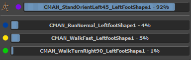

The Motion Clips visual feedback is showing the Motion Clip name and the
current amount of this animation used in the Locomotion Behavior. The
"First Motion" (see the Replay Ratio parameter in the First Motion
Attributes of the Locomotion Behavior) Clip is
marked with
and is displayed in
purple

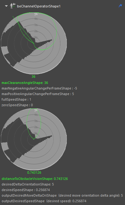

Channel Operator Behavior Visual Feedback
Visual Feedback of the Channel Operator Behavior
The ChannelOperator Behavior visual feedback shows the name of the executed channel operators (in the order of execution) and the returned values.

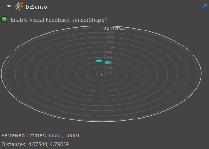

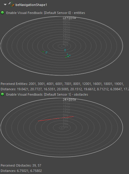

Activate Sensor Behavior Visual Feedback
The Activate Sensor Behavior visual feedback displays a radar view of the perceived entities or obstacles, as well as two lists, one with their ids, called Perceived Entities/Obstacles, and another one with their distances to the selected entity, called Distances. If the Enable Visual Feedback button is unchecked, the radar view and the two perceived objects lists are not displayed, and there is no display for this sensor in Maya's viewport.
Navigation Behavior Visual Feedback
The Navigation Behavior visual feedback displays the same visual feedback view as the Activate Sensor Behavior for each of its sensors.

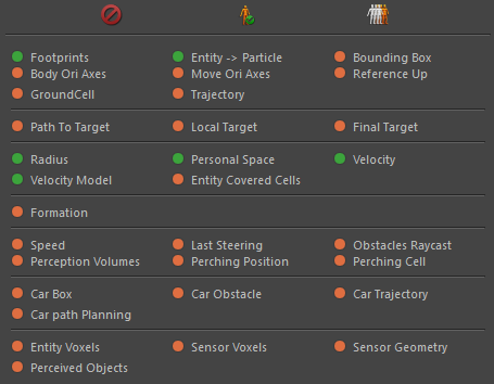

Maya Viewport Settings
Maya Viewport Settings in Crowd Visual Feedback
This panel contains several settings to control Maya viewport Visual Feedback. These settings are the same as ones defined in the Crowd Manager and can be displayed on the currently picked Entity, all the entities, or a subset.
Visual Feedback display option for Specific Entity Ids
| Display on |
| Specific Entity Ids | See above |
Entity Feedback
| Footprints | Draw a circle at the foot position when it's on ground |
| Entity -> Particle | Draw a link between an Entity and its particle |
| Bounding Box | Draw a semi-transparent bounding box englobing the Animation Posture |
| Body ori axes | Draws a tripod matching the body orientation |
| Move ori axes | Draws a tripod matching the move orientation |
| Reference Up | Indicate which axe is considered as the up vector, used for ground adaptation and other features. |
| Ground Cell | Highlight the boundary of the current ground cell the entity lies in |
| Trajectory | The predicted motion trajectory |
Goto Feedback
| Path To Target | Draw the planned path to the Entity's final Target |
| Local Target | Draw the Entity local target (or targeted formation slot) |
| Final Target | Draw the Entity final destination target (or targeted formation slot) |
Navigation Feedback
| Radius | Draw a wire circle around the character |
| Personal Space | Draw the Personal Space around the Entity |
| Perceived Obstacles | Draw a line between the Entity and every obstacles perceived |
| Velocity | Draw a the Entity velocity vector |
| Velocity Model | Draw the Velocity Model |
| Entity Covered Cells | Highlight the cells covered by the entity radius. |
Formation Feedback
| Formation | Draw the formation shape |
Steer Feedback
| Speed | Draw the current speed (from position to position+speed) |
| Last Steering | Draw last boid steering force (from position to position + steering) |
| Obstacles Raycast | Draw boid rays for obstacle detection : one from entity position in speed direction, 4 others from radius borders which describe a 45° cone around speed. |
| Perception Volumes | Shows the arc and radii of the separation, alignment and cohesion perception "volumes" from the boid. |
| Perching Position | Draws a tripod at the target perching position (may move during the perching phase if the ground is moving or if a perching speed has been chosen) |
| Perching Cell | Highlight perching cell boundary |
Perception Feedback
| Entity Voxels | Draw the Entity voxels |
| Sensor Voxels | Draw the sensor voxels |
| Sensor Geometry | Draw the sensor geometry |
| Perceived Objects | Draw the perceived objects |
Traffic Feedback
| Car Box | Draw a 2D rectangle showing the car size in simulation (related to width / length of population). Beware it could be hidden under the geometry if configured too small. |
| Car Obstacle | Draw a line from the car to its closest obstacle, if any. |
| Car Trajectory | Draw the car trajectory forecast |
