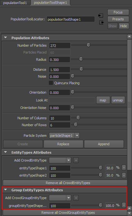

Create a Population Tool Locator
As usual, created EntityTypes are added in the EntityTypes Attributes Panel. You need to add your GroupEntityType in the GroupEntityType panel to specify that the placed Entities will be part of this group.

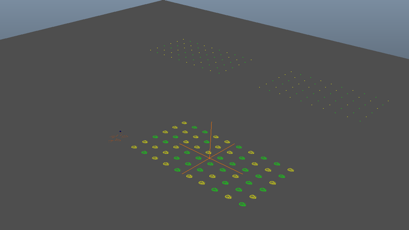

Emit the particles. It will create a single group entity from your GroupEntityType.
If you want to create more groups of this type, you can just move the Population Tool Locator and re-emit particles (either in the same or in a different particle system). You can also create different Population Tool Locators using the same GroupEntityType.

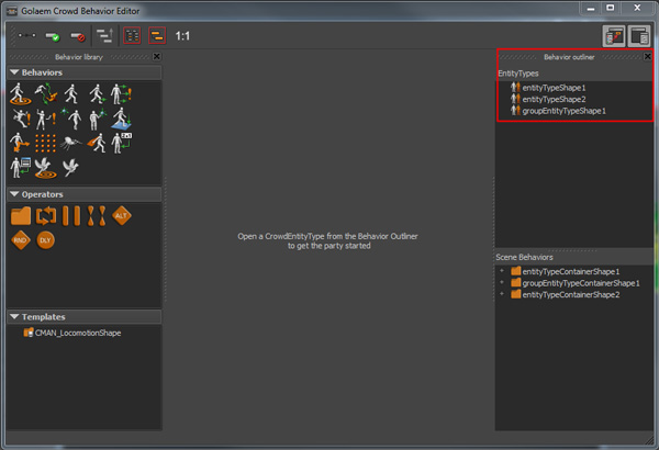

The next step is to configure the behavior of the group. If you open the
Behavior Editor
you should be able to see both the EntityTypes forming your group and
the GroupEntityType controlling them in the Behavior Outliner.

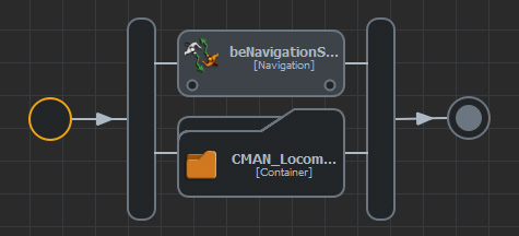

Individual Entities
For a typical navigation setup, you need to add a Navigation Behavior and Locomotion Behavior in each of the EntityTypes forming your group.
When these EntityTypes are used with a GroupEntityType, any Goto Behavior will be ignored on the individual entities, as they act as part of the group, and follow it.

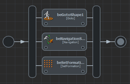

Group Entity
Next you need to configure the Group Entity. If you want the group to be able to move, you need to add a Navigation Behavior. This is where you can also add a Goto Behavior for the whole group, as well as the SetFormation Behavior:

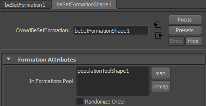

The SetFormation Behavior uses Population Tool Locators as input in order to define the shape of the formation.
The Population Tool Locator used to place your characters can be used, but you can also map another Population Tool Locator to keep another shape. It is even possible to map multiples Population Tool Locators so that they will transition between shapes each time the SetFormation Behavior is restarted.
