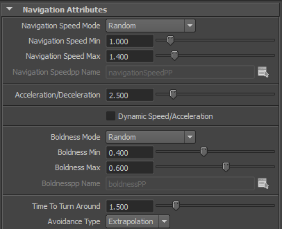

Navigation Speed Mode
This attribute lets you choose how the navigation speed of each crowd entity is set:
  • Random: the navigation speed is set randomly between the values Navigation Speed Min and Navigation Speed Max. The navigation speed is influenced by the random seed of the Crowd Manager.
  • Per-Particle Attribute: the navigation speed is read from the per particle float attribute given by Navigation Speedpp Name.
The Navigation Speed value is in Crowd units.
Navigation Speed Min See the Random option of the Navigation Speed Mode described above. Available only when the Navigation Speed Mode is set to Random.
Navigation Speed Max See the Random option of the Navigation Speed Mode described above. Available only when the Navigation Speed Mode is set to Random.
Navigation Speedpp Name  Name of the float per-particle attribute containing the Navigation Speed value to use. For more explanations about how to use ppAttributes, see ppAttributes Handling
The Navigation Speed is set to 1 if the pp attribute name is empty or invalid. Available only when the Navigation Speed Mode is set to Per-Particle Attribute.
Acceleration/Deceleration The maximum acceleration or deceleration allowed for navigating entities.
Dynamic Speed/Acceleration  When enabled, the Navigation Speed and Acceleration will be reread and changed dynamically while the behavior is running.
Boldness Mode
The boldness attribute of an entity controls how much an entity takes his neighbors into account in the navigation algorithm. The greater the boldness the less the entity will try to avoid its neighbors, simulating a "bold" behavior.
This attribute lets you choose how the boldness of each crowd entity is set:
  • Random: the boldness is set randomly between the values Boldness Min and Boldness Max. The boldness is influenced by the random seed of the Crowd Manager.
  • Per-Particle Attribute: the boldness is read from the per particle float attribute given by Boldnesspp Name.
The Boldness value is between 0 and 1.
Boldness Min See the Random option of the Boldness Mode described above. Available only when the Boldness Mode is set to Random.
Boldness Max See the Random option of the Boldness Mode described above. Available only when the Boldness Mode is set to Random.
Boldnesspp Name Name of the float per-particle attribute containing the Boldness value to use. For more explanations about how to use ppAttributes, see ppAttributes Handling
The Boldness is set to 0.5 if the pp attribute name is empty or invalid. Available only when the Boldness Mode is set to Per-Particle Attribute.
Time To Turn Around
The time it takes to do a 180 degrees turn. This parameter defines the maximum angular velocity of a navigating entity and can be used to facilitate (lower value) or make it more difficult (greater value) to turn.

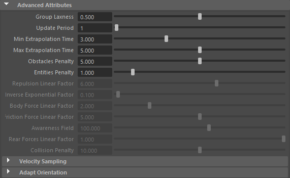

This layout contains advanced parameters intended mainly for advanced users.
Advanced attributes of a navigation behavior
Group Laxness Specific to groups. Determines the individual navigation behaviors of entities inside a group, how lax they will be in trying to keep the formation when avoiding obstacles, or other entities. See Set Formation.
Update Period (in frames)
Determines the number of frames to wait before updating the navigation (1 meaning that the navigation is updated at each frame). Increasing this parameter also increases performance but the navigation will be less precise.
Min Extrapolation Time, Max Extrapolation Time
Specific to the Extrapolation algorithm. Time interval in which the entity predicts other entities/obstacles position to calculate the path to avoid it. A low value of 1 sec for min and max, means the entity predicts the position of others 1 sec ahead.
The actual extrapolation time is computed as a weighted average between the two parameters, using the boldness as weight (i.e.  Extrapolation Time = Boldness * Min Extrapolation Time + (1 - Boldness) * Max Extrapolation Time ).
Obstacles Penalty Specific to the Extrapolation algorithm. Determines how far away from obstacles the entity will try to navigate. In other words it influences the distance at which the entity goes around the obstacle, a low value keeps it close to the obstacle and a high value keeps it far away.
Entities Penalty
Specific to the Extrapolation algorithm. Determines how far aways the entity will navigate from other entities to avoid collision. In other words it influences the distance at which the entity goes around other entities, a low value keeps it close to the other entities and a high value keeps it far away.
Repulsion Linear Factor Specific to the Social Force algorithm. It linearly increases the repulsion force.
Repulsion Inverse Exponential Factor Specific to the Social Force algorithm. When this factor increases, the repulsion force increases exponentially.
Body Force Linear Factor Specific to the Social Force algorithm. The body force counteracts body compression from neighbors.
Friction Force Linear Factor Specific to the Social Force algorithm. The friction force reduces speed due to physical contact with neighbors.
Awareness Field Specific to the Social Force algorithm. Angle in degrees describing the field of view of an entity. The effective angle of view is twice this value. All forces not in the field of view are decreased by the Rear Forces Linear Factor (see below)
Rear Forces Linear Factor Specific to the Social Force algorithm. The linear factor applied to forces that don't belong to the awareness field. If set to 1 (default), the awareness field has no influence.
Collision Penalty Specific to the RVO algorithm. It determines how far away from other entities the current entity will try to navigate. Increasing this parameter will make the entity try to stay further away from other entities. Its the penalty applied linearly to the minimum time to collision.

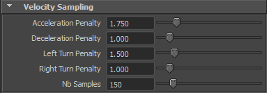

Velocity Sampling
These parameters are specific to the Extrapolation and RVO algorithms. The two algorithms work by choosing the best velocity among a sample of velocities (the one with the lowest penalty). The samples are built with default penalties defined with the parameters below.
Acceleration Penalty / Deceleration Penalty Sets the preferences of the entity in avoidance. A higher Acceleration Penalty value than Deceleration will make the entities favor Deceleration to avoid other entities.
Left Turn Penalty / Right Turn Penalty Determines whether the entity favors right or left turn to avoid other entities. A higher value of Left Turn Penalty than the Right turn would make the entities favor Right turn during avoidance.
Nb Samples Number of velocity samples used to compute the avoidance. Higher samples result in better avoidance but decreases performance.
