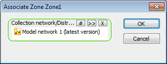

This dialog is used when linking a database item to a GeoExplorer zone. Items that can be linked to a GeoExplorer zone are:
- Asset groups
- Networks
- Workspaces
See the GeoExplorer topic for details.
The dialog is displayed when:
- A GeoExplorer zone is selected in the
GeoExplorer window using the link tool
from the
GeoExplorer toolbar.
- The Update Associated Item menu item is selected from the GeoExplorer zone grid window. (Right click in a cell in the grid window of the zone to be updated to display the menu.)
Use drag and drop or the
button to add a
Asset Group, Network or Workspace in the appropriate selection box. Use the
button to remove a selection. Only one item at a time may be selected for association.
Click OK to associate the selected item with the zone.
