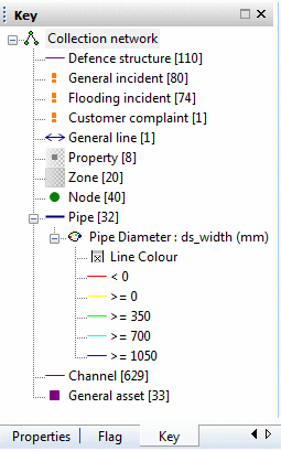

This is a dockable window that can be used to:
  • Provide a visual reminder of the GeoPlan Window symbols and the current themes for all open GeoPlan Windows.
  • Display or hide object types on the GeoPlan.
  • Disable and enable themes on the GeoPlan.
The keys are displayed in a tree structure. Use the and buttons to move around the tree.
Tip: A count of the number of each type of object in the network is shown in brackets next to the object symbol.
Display the window by clicking in the Docking Windows Toolbar or choosing Thematic Key window from the Window menu. Both toggle the display of the window, so clicking either again will hide the window.
The Thematic Key window data can be printed alongside the network when printing from the GeoPlan Window. (When using the Classic printing method, the sections of the key that are printed are the ones that are open at the time of printing.)
Themes are edited using the Layers and Themes page on the GeoPlan Properties dialog. To open the GeoPlan Properties dialog for the correct GeoPlan, double-click an appropriate item on the Thematic Key window.
