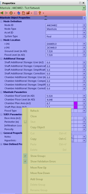

The OPW is a modeless window providing a way of looking at all the data for a single network object in a structured way. It encompasses all the properties of the object, presented in a tree view. Properties are grouped in Property Groups that are entirely customisable.
The OPW behaves like all other windows in InfoAsset Manager. See Windows and Using Dockable Windows for details. In the following screenshot, the window components have been highlighted in different colours for a better visual effect, and are described in detail in the sections below.
Green - DropTree
Red - Toolbar
Blue - Caption Bar + Properties
Yellow - Context Menu

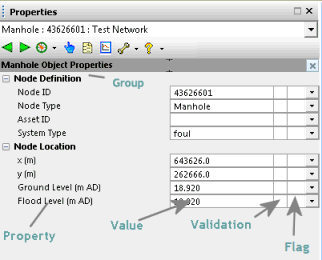

Property editor
Excerpt of Properties
Properties are initially classified in system-defined groups. A user may add, delete and rename groups, and save the layout on a per user basis.
Property items are object-dependent and may contain the following parameters:
Property Item |
Description |
Name |
Field description which (ideally) uniquely identifies the object property and value units. |
Value |
Either the object property value or a visual cue indicating that a preview of the object property value is available. Tip: If there is not enough space for a property value in a box, click on the
button to display more information (i.e. notes, hyperlinks).
Validation |
Validation errors are displayed against each property by default. A coloured icon indicates if the object property has a validation error or warning (If the cell is empty, there is no validation error or warning). Hovering over a validation icon with the mouse will display a tooltip with details about the validation error, such as the name of the network object where the anomaly occurred as well as the cause of the error/warning. See Tooltips section below for further details. It is possible to hide the validation messages on the OPW (See Object Properties Window Settings dialog for more details). |
Flag |
Flag associated with the current object property value. Many network object data fields can have additional information recorded using a data flag. This information may include:
Data Control and Associated Flag When editing data on an OPW many controls will have an associated flag control immediately to their right. Select the appropriate flag from the dropdown. For more details about using flags with your data, see Data Flags. |

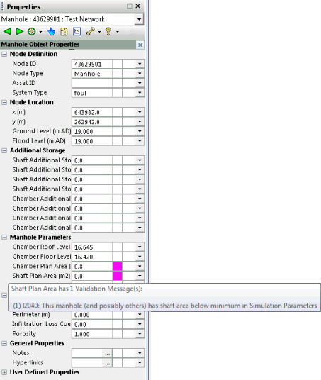

Tooltips
When some areas of the OPW (e.g. DropTree, property, validation error) are hovered over with the mouse, a non-editable and non-customisable tooltip with some information of the item being hovered gets displayed.
Example of property tooltip
Example of validation error tooltip

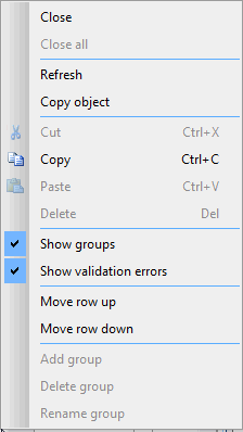

Context menu
Example of Context menu
When you right-click on a group, a property, a value, an error message or a flag on the OPW, a context menu like the one shown above is displayed, allowing you to perform a large variety of tasks.
Depending on which item is clicked, or which view of the OPW is displayed (network object properties or object type layout), some of the options may be disabled. See Using the Object Properties Window for more details on each of the available options on the context menu.
