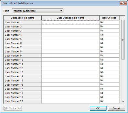

The dialog is displayed when you select Database management
User defined field names from the File menu, and is used to edit the field names of User Fields for the current database.
Both Model and Asset network field names can be edited.
User Defined Field Names Dialog displaying Asset (Collection) Network user fields
User Defined Field Names entered in the dialog will be used as the global default for the current database. However, network specific User Field names will override the global default names. See Editing Global User Defined Field Names for more details.
It is also possible to edit the choice lists for User Text fields via this dialog. Click a user text row and click the Edit Choice List button to display the Standards and Choice Lists Dialog. See User Defined Choice Lists for more information.
