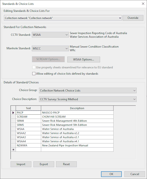

Editing of InfoAsset Manager choice lists is carried out in the Standards and Choice Lists dialog.
Example of the Standards and Choice Lists Dialog
To edit database data, display the dialog by selecting Database managementStandards & choice lists from the File menu. The menu option is available when there are no networks open.
Database standards and choice lists can be overridden for a particular network. To edit options for the current network, open the dialog by selecting Standards & choice lists from the Network menu.
Due to the large number of InfoAsset Manager choice lists available, the lists are divided into five main groups. The groups separate the choice lists by network type and separate the network User Text fields from the other network fields. There is also a separate group for GeoExplorer Zone choice lists.
To select a choice list for editing, select the appropriate group from the Choice Group list. Select the choice list to be edited from the Choice Description list which contains the choice lists relevant to the selected choice group.
There are a number of choice lists that are used by more than one network object. Choice lists that are shared between object types are prefixed by '(Multiple Object Types):' in the Choice Description list (see the Choice Lists Shared Between Network Objects section below for details). All other choice list names are prefixed by the network object type to which they are associated.
To add a new choice to a list:
  1. Select the appropriate list using the Choice Group and Choice Description lists.
  2. Scroll to the bottom of the list if necessary and click in the append row (marked with a ). If there is no append row then this list cannot be edited.
  3. Enter a new code and description in the Text and Description columns.
  4. Move off the append row to save changes.
To delete an existing choice from a list:
  2. Select the entire row for the choice to be deleted. To do so, click on the grey square to the left of the row.
  3. Click Delete.
To reset a choice list to its default settings:
  2. Click Reset.
  3. Click OK on the Choice List Reset dialog to restore the currently displayed choice list to its default settings.
  4. (Select the Reset all choice lists option on the Choice List Reset dialog to restore all choice lists in all choice groups to their default settings.)
