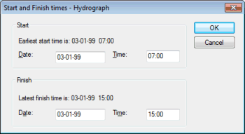

  1. The Start and Finish Times dialog displays the earliest start time and latest finish time from the data selected for import. The times can be manually adjusted, but only within the times originally displayed. Click OK to add the Time Varying Data to the database.
A different Time Varying Data is created for each type of data imported. These are given default names (Depth, Flow etc.) which may be changed.

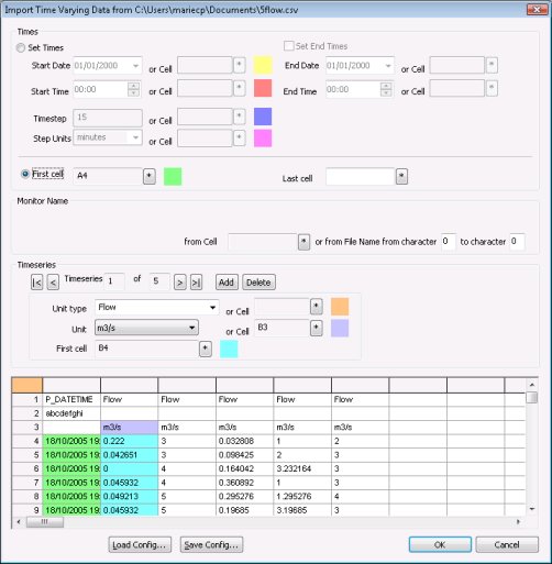

  1. Right-click on a Time Varying Data Asset Group or Time Varying Data Item in the Explorer Window and select Import | from generic CSV file from the popup menu. A standard Windows Open dialog is displayed.
  2. Select the files to be imported (multiple files may be selected) and click Open.
  3. The Import Time Varying Data from CSV Dialog is displayed.
Show me
  1. Set the import parameters on the import dialog. Values can be entered directly or read from the file to be imported. To read a value from the file, click on a cell in the grid at the bottom of the dialog and then on the * button.
    • Times: specify the time range of data to be imported:
      • If the file is a standard logger format file, the Set Times and Timeseries unit information should automatically be set up from the header information in the CSV file.
      • If the file contains a date-time column, use the First Cell and Last Cell fields to enter the cells defining the time range of data to be imported.
      • If there is no date and time information, specify start and end times and a timestep interval.
      (Specification of an end time is optional; if no end time is specified all data from the first cell to the end of the timeseries will be imported.)
    • Monitor Name: specification of a monitor name is optional. The monitor name will be applied as the event profile ID (link label or node reference).
      • To read the monitor name from the file, select the cell in the grid at the bottom of the dialog containing the monitor name and click on the * button.
      • To derive the monitor name from the name of the file to be imported, enter the range of characters in the file name to be used. (For example, when importing a file named Monitor1_001, enter from character of 8 and to character of 12 to import a monitor name of 1_001.)
    • Timeseries: set the parameters for each time series in the file. For each timeseries (column of data) to be imported a Unit Type and Unit must be defined. The Add and Delete buttons can be used to include and exclude timeseries from import. The underlying data will not be changed.
  2. Click OK to complete the import. A Time Varying Data object will be created for each data series imported.
