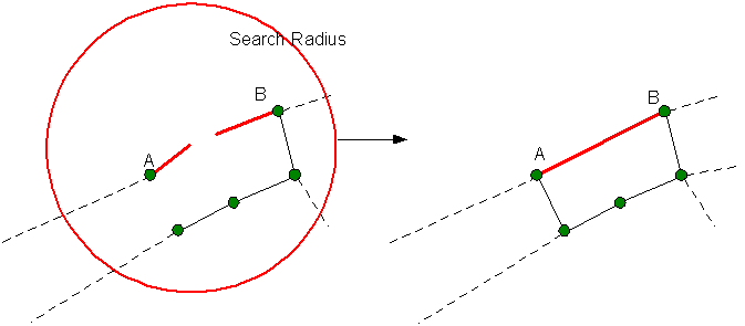

Merge Unknown Ends Methodology
The Merge Unknown Ends rule is used to search for pairs of opposing Unknown ends within a user defined Search Radius. If the pipes found satisfy defined parameters, the unknown ends of the pipes will be merged into one pipe.
- The pair of pipes to be merged must have at least one end that is not Unknown for merging to be carried out.
- Only unconnected ends of pipes with anUS Node ID / DS Node ID using an Unknown Nodes name will be considered for merging during the inference process. (See Reserved Node Names).
- When running the inference on a selection, only selected pipes will be considered for merging.
- The upstream end of a pipe will only be merged with the downstream end of another pipe, and vice versa.
- Pipes to be merged must have difference in bearing no greater than 90°.
- The Height and Width at the opposing unknown ends of the pipes to be merged must be within the Tolerance specified in the Inference Editor.
- If attributes are to be matched:
- the upstream attributes of the pipes to be merged must be equal to each other
- the downstream attributes of the pipes to be merged must be equal to each other
- If more than one pipe satisfies the merging conditions to an unknown end, the nearest pipe will be used.
Click on the image below to reveal the related example.
Example
Pipes A.Unknown.1 and Unknown.B.1have opposing ends. Inference is carried out by the following method:
- A search is carried out for pipes with an unknown end. Pipe A.Unknown.1 is found.
- A search for unknown ends within the search radius from the unknown end of pipe A.Unknown.1 is carried out. Pipe Unknown.B.1 is found.
- A check is carried out that at least one of the pipes has a known end that exists in the network.
- A check is carried out that the difference in bearing between the pipes is not greater than 90°.
- The Upstream attributes of pipeA.Unknown.1 match the Upstream attributes of pipe Unknown.B.1. The Downstream attributes of pipe A.Unknown.1match the Downstream attributes of pipe Unknown.B.1. The pipes are merged.
