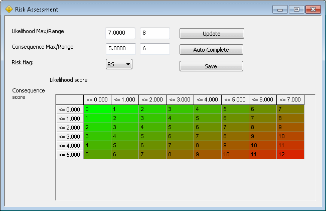

The Risk Assessment Editor is used to specify a matrix of risk scores defining the relationship between overall risk of structural failure, likelihood of failure and consequence of failure of a pipe. The risk score of pipes in the network can then be updated with the values set in the editor.
To open the editor drag the Risk Assessment object from the tree to the main window, or right click on the Risk Assessment object and select Open from the context menu.
See the Risk Assessment topic for further details.
Show me
| Risk Assessment option | Description |
| Likelihood Max/Range | The maximum Likelihood score and the number of ranges to display in the Risk score matrix. |
| Consequence Max/Range | The maximum Consequence score and the number of ranges to display in the Risk score matrix. |
| Risk flag |
Select a flag to be applied to fields updated when the Risk Assessment is run. |
| Risk score matrix |
Matrix of risk scores defining the relationship between overall risk of structural failure, likelihood of failure and consequence of failure of a pipe. Values may be manually edited, or automatically populated by use of the Auto Complete button. |
| Update button | Click this button to update the number of rows and columns in the Risk score matrix according to the Likelihood and Consequence Max and Range values specified in the editor. |
| Auto Complete button | Click this button to automatically populate the Risk score matrix with risk score values. |
| Save button | Click this button to save changes made to the editor. |
