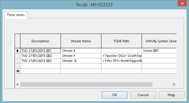

This grid is used to link new or modify existing time series data streams to any of following types of InfoAsset Manager network objects:
When a data stream is linked to a network object, the associated time series data can be displayed using either the
button on the
toolbar, the
button from the object's property toolbar or by selecting the Time series data source option from an object's context menu.
The Time Series Data Source grid is displayed when you:
- Click
from the TSBD Links field in the object properties window
Property Sheet.
- Display the Time Series page in the tabbed Property Sheet.
To link the object to one or more data streams, specify the required information into the grid, and then click OK to commit the changes.
The database fields listed in the grid columns are described below.
