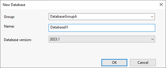

New Database Dialog
This dialog is displayed when you click New in the Open Database dialog for a workgroup database.
The dialog is used to:
  • Select or add a new group to which the new workgroup database can belong
  • Specify the name for a new workgroup database
  • Select the version of the database that is to be used to create the new workgroup database
Dialog description
Item Description
Group
The name of a group that the workgroup database can belong to.
The names of groups already defined are contained in the dropdown.
Name
The name of a workgroup database.
Database version
The database version for the new workgroup database. The available versions are listed in the dropdown.
Note: The oldest version available is 2023.0.
OK
Saves any changes and closes the window.
Cancel
Cancels any changes and closes the window.
