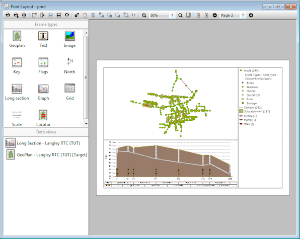

The Print Layout View is used to load, customise and save Print Layout templates.
The Print Layout View is displayed when the FilePrint layout menu option is selected.
There are three panes in the Print Layout view
  • Frame types pane: list of the different frame types that can be included in the printed output by dragging onto the Page pane
  • Data views pane: list of windows onto current network views that can be dragged onto the Page pane. To refresh the list of current data views, double-click on the data view pane. Drag a data view to the Page pane to create a new frame, or drag the data view in to an existing frame of corresponding type to replace contents of frame with selected data view contents.
  • Page pane: the right-hand pane which shows a preview of the print.
To create a print layout:
  • Drag a frame or data view from the left-hand pane to the page pane. A new frame will be drawn on the page.
  • Click on the frame to highlight it in blue. The frame can be repositioned by dragging with the mouse. The frame can be resized by dragging the handles. Hold Ctrl to select multiple frames.
  • Double-click the selected frame to show its properties. Alternatively click the properties button on the toolbar.
Some frames may require an associated frame in order to be displayed. For example, the key frame requires a GeoPlan frame to be selected as an associated frame. This ensures that the key being displayed is the correct one for the GeoPlan being displayed. When the key frame is created it is associated with the most recently created GeoPlan frame on the page by default. The association can be edited on the association tab of the Print Layout Properties Dialog. When a frame with an associated frame is clicked on, the associated frame is highlighted in yellow.
