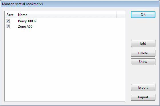

Manage Spatial Bookmarks Dialog
This dialog is displayed by selecting the GeoPlanSpatial bookmarksManage bookmarks menu option, or by double-clicking on the network entry in the Spatial Bookmarks Window.
A version of the dialog named Select spatial bookmarks, is displayed when using the batch print functionality from the Print Layout View.
The dialog displays a list of all Spatial Bookmarks for the current network. The status of the check boxes indicates whether the bookmarks are saved to the network or not, (if the box is ticked, the bookmark is saved to the network).
When carrying out batch printing from the Print Layout View, the check boxes are used to select which bookmarked views to print.
The buttons on the dialog allow the user to manage the Spatial Bookmarks for the current network.
Button Description
Edit Displays the Spatial Bookmark Dialog for the currently selected bookmark.
Delete Deletes the currently selected bookmark.
Show Displays the view extents of the currently selected bookmark in the GeoPlan Window.
Export
Exports all listed Spatial Bookmarks to .xml format.
Click Export to display a standard Windows Save As dialog. Select the path to save the exported file to and click Save.
Import
Imports Spatial Bookmarks from an .xml file.
Click Import to display a standard Windows Open dialog. Select the .xml file to import and click Open.
Tip: Existing bookmarks will be removed prior to import.
OK Closes the dialog.
