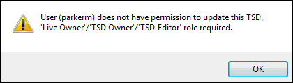

Permissioned dialogs or options will be read-only for users who have not been assigned the required roles. Alternatively, a warning message of the type of the screenshot shown below will be displayed if users attempt to perform an action for which they do not have the required permission:
