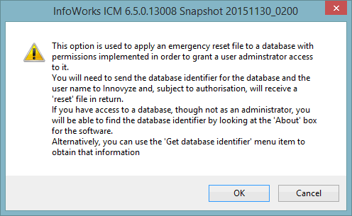

Resetting Permissions
In the event that it is necessary to reset user permissions for a database, it is possible to grant a user administrator access to a database via an emergency reset file.
An emergency reset file can be obtained from Innovyze. In order to generate the reset file, database identifier and user name information will be required.
In order to apply the emergency reset file to a database and grant administrator access to a user:
  • Select the menu option FileDatabase managementEmergency permissions reset.
  • An information message will be displayed. Click OK.
  • Note: Ensure that the required user name (as shown in the Users and Permissions dialog) and the database identifier are sent to Innovyze.
  • The relevant Open Database dialog will be displayed. Select the database to be reset and click OK.
  • A standard file open dialog will be displayed. Select the reset file to be used and click Open.
