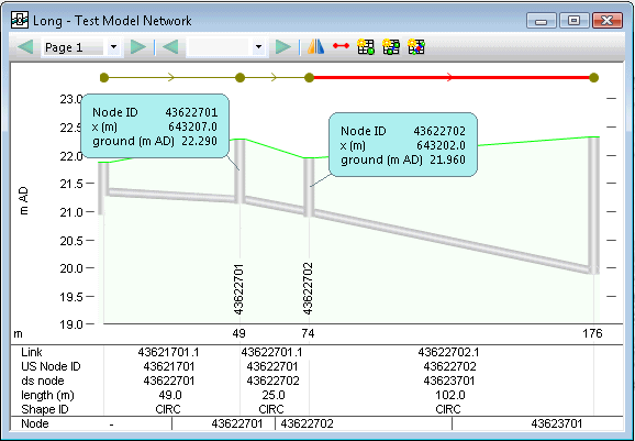

You can choose to display labels for nodes, links or both. Grid labels are displayed for all objects in the long section along the bottom of the view and custom labels are displayed on the Long Section Window in callouts.
Example of Long Section Window in InfoWorks ICM. The picture shows grid labels for linksdisplayed across the bottom of the view and custom labels for two nodes.
To change the labels displayed, click Field Settings on the Section Properties dialog to access the Network Label Field Settings dialog.
