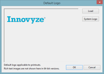

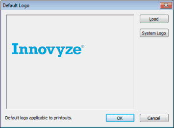

Default Logo Dialog
This dialog is used to select the logo to be used as the default logo, to be applied to printouts for the current database. It is displayed when Database managementDefault logo is selected from the File menu.
Click Load to select a Rich Text Format (.rtf) file to be used as the default logo.
Click System Logo to set the InfoWorks ICM logo as the default logo.
Note: If you are using a 64 bit version of InfoWorks ICM, and the RTF file contains an image, then the image will not be displayed in the Logo pane of the Default Logo dialog.
RTF text is not affected and will be displayed in the Logo pane.
The logo (RFT text and/or image) can be viewed before printing by selecting Print preview from the File menu.
