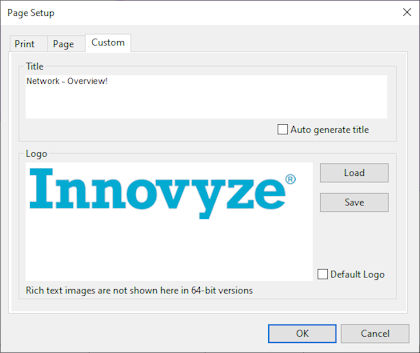

Print Setup Logo Dialog
This dialog is used to set the title and logo options when printing the following views:
To display the dialog, click Logo on the Page Setup dialog for the view. (To display the Page Setup dialog, select Page setup from the File menu.)
When printing the GeoPlan Window, the options on this dialog are available from the Custom page of the GeoPlan Print dialog.
Title options
A user defined or automatically generated title can be included at the bottom of the printout:
  • Check Print title to include the title in the printout.
  • Check Auto generate title to use a title generated by InfoWorks ICM. An existing title in the Title text box will be overwritten by the generated title.
  • To edit the title, uncheck the Auto generate title box and edit the title in the text box.
Logo options
The logo is a piece of Rich Text Format text that can be included at the bottom of the printout:
  • Click Load to load an existing Rich Text (.rtf) file created in an external package such as Microsoft Word.
  • Alternatively paste text or images into the logo box and then click Save to save the image as a Rich Text file.
  • Check Default Logo to use the default logo set in the Default Logo dialog.
