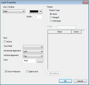

ArcGIS Engine and ArcGIS Desktop Layer Properties dialog

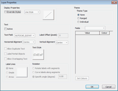

MapXtreme Layer Properties dialog
Fill Line/Outline Marker |
The properties available for editing will depend on the type of objects in the layer. Colors, patterns, line widths, symbols and symbol sizes can be edited. |
Text |
Text associated with layer objects can be displayed by checking the Active box. Edit the text appearance using the dropdown boxes. Check the Draw Features box to make layer objects visible. Check the Spline text box to display text at the orientation saved in the layer file (text will displayed horizontally if this box is unchecked). |
Theme |
There are three options for displaying a Theme:
MapXtreme
Display Properties |
Use to define how the objects in the layer are drawn. |
Text |
Text associated with layer objects can be displayed by checking the Active box. Edit the text appearance using the drop down boxes. It is possible to add label lines or arrows (Label lines section and to rotate labels (Rotation section). |
Theme |
