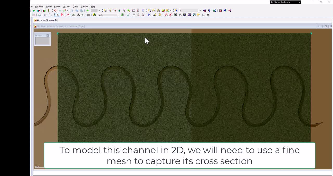

Subgrid Sampling Technical Preview *
Subgrid Sampling (Technical Preview) is a method for enhancing topographic representation in an InfoWorks 2D model, where the software performs a third clip meshing phase to create a finer triangular mesh for each 2D element inside a 2D zone and any associated Mesh zones, where Subgrid Sampling is to be applied. Subgrid triangles for each 2D element are used to build volume/level tables which, in combination with the 2D face ground levels, define the interface crest levels between 2D elements. See Subgrid Sampling and Subgrid Sampling Methodology for further information.
Using Subgrid Sampling improves InfoWorks ICM's predictive ability without compromising performance speed or result accuracy. The following video highlights the benefits of using Subgrid Sampling:
Video Player is loading.
Current Time 0:00
Duration 1:31
Loaded: 0%
0:00
Progress: 0%
1x
Using Subgrid Sampling is relatively simple as you only need to check the Subgrid Sampling box and specify the Subgrid Sampling triangle area in a 2D zone or a Mesh zone properties. And if you include a Mesh zone in your model, you can also choose to use the subgrid values specified for it, rather than the ones specified for the 2D zone, by checking the Mesh zone's Override 2D zone Subgrid Sampling box.
There are no licence restrictions for applying Subgrid Sampling to a model. However, to generate a mesh or run a simulation, where a 2D zone or Mesh zone has Subgrid Sampling applied, requires a licence with unlimited elements.
See Using Subgrid Sampling for information about using Subgrid Sampling in a 2D zone or Mesh zone.
As Subgrid Sampling is a Tech Preview, there are a limited set of modelling capabilities, network objects and mesh functionality that can currently be used with it. These are listed in Supported items.
If you try our new Tech Preview feature, we would really appreciate your feedback before it's officially released.
Please send your feedback to FeatureFeedback.InfoWorksICM@autodesk.com
