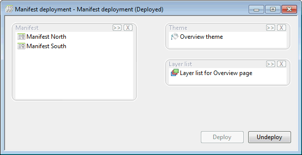

The items in the Manifest Deployment dialog are described below.

Manifest
The manifests included in this manifest deployment. At least one manifest must be included.
Theme
The theme to be used for displaying for the Overview GeoExplorer.
You can setup a GeoExplorer theme for areas of interest (AOI), AOI alert counts or AOI alert priorities. This theme will be used on the Overview Page of the ICMLive Operator Client to highlight areas of interest which contain alerts for the most recent simulation.
If no theme is specified in this droptarget, the default theme is used.
Layer list
A layer list.
The specified layer list will be used on the Overview Page of the ICMLive Operator Client to provide background layers.
Deploy
Deploys the manifest deployment.
Deploying it saves the object, validates it and makes it available for selection in ICMLive Operator Client. It also results in the Innovyze Live Server processing the manifests and performing ICMLive runs according to each manifest run schedule.
Undeploy
Undeploys the manifest deployment.
Undeploying it is a way of temporarily isolating it, either because the user no longer wants to run it, or because it needs editing.
