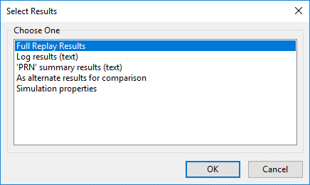

- Right-click the 'Obs4p' simulation (which is in the 'Langley Observed 4' run in the Run Group in the
Explorer window).
- Select Open As from the pop-up menu, and a selection window is displayed containing a list of result types:

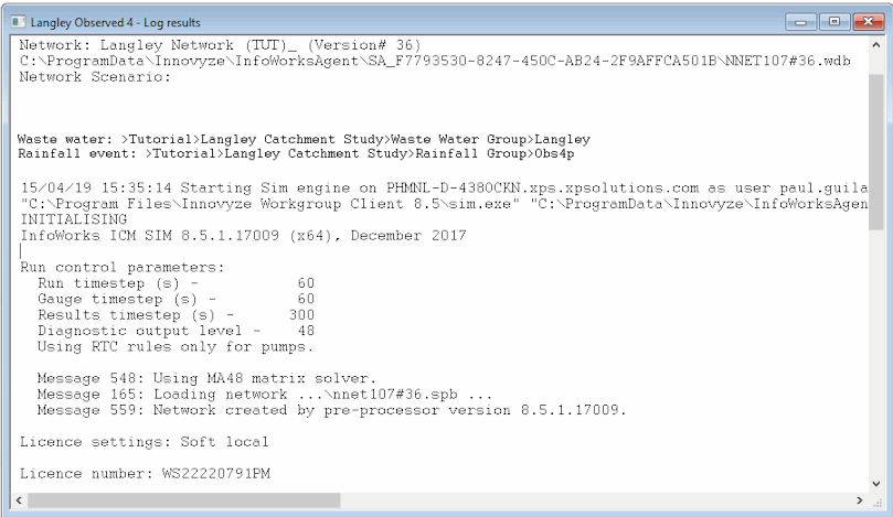

- Click the 'Log results (text)' option and then click OK. The text window shows a log of the actions carried out during the simulation.
- Use the scroll bars to move around the report and check for any messages that indicate that there may have been a problem with the simulation. If there are any problems in the simulation, the data it produces may not be reliable. After checking the log, close the window. Click the
button in the top right-hand corner of the window.

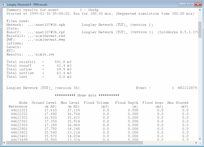

- Right-click the 'Obs4p' simulation and select Open As. This time, choose the 'PRN' option. The results are shown as a text-based report.
- Use the scroll bars to move around the report and inspect the data. When you have finished, close the window. Click the
The PRN report shows you the raw data.
